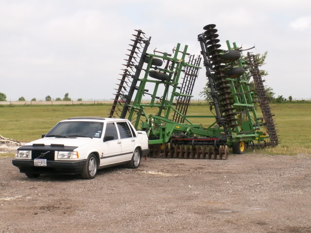

Well, the wagons come stock with heavier springs to offset the tongue weight. I presume since you mention IPD that perhaps springs have been considered. Since you're using them as trucks are they all wagons? Can't imagine doing reno/resto working out of a sedan...here's a link to a discussion on towing and a pic of the only thing I have really towed w/ my 740...
https://volvoforums.com/forum/showth...ghlight=towing

Swiftjustice44 great picture, and great snark in your remarks about mountains in NC. I am in Utah, so our mountains are real.

Swift, do my eyes deceive me, is that the VOBRA, towing a harrow?
Fred
Old Jan 25, 2011 | 01:05 PM
swiftjustice44's Avatar
Joined: Aug 2008
Posts: 2,580
Likes: 9
From: Dallas, TX
Well, yeah...that's just how we roll in Texas!
