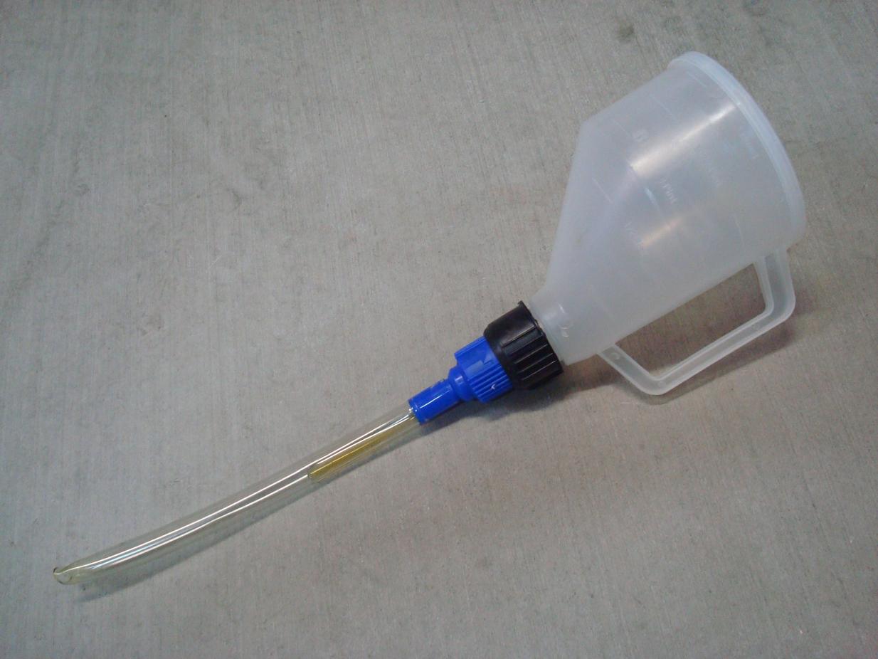

transmax import is what I used...
I got one of those fancy transmission funnels with a on/off valve at the bottom and a clear vinyl hose with a fitting for the dipstick tube. I cut the hose way shorter than it came, and rigged up a coat hanger to hang said funnel off bottom of hood.
my method was to first warm up the transmission thoroughly (I drove about 15 miles on county roads), then use a oil sucker to get as much out of the dipstick as I could, this got about 2-3 quarts. disconnect that top hose, run it into a graduated container, and now through the dipstick tube add as much ATF as you removed with the oil sucker.
start the engine and let it idle, each quart that comes out into your container, add a quart, I did this as a continuous process, repeat this until the stuff coming out is clear red. shut off engine, replace cooler hose.
test drive a few miles, with engine idling, check trans dipstick, and top off if needed.
note, btw, these transmissions don't have a conventional filter inside, they do have a screen, and its not a bad idea to drop the pan and check/clean this screen, it rarely needs replacement unless you abuse it.... before dropping the pan, clean the heck out of everything around it, as even a speck of grit can destroy a transmission.

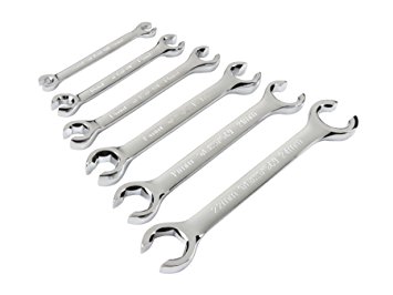

you need a pair of flare wrenches for those. one for the hex on the fixed part of the insert, the other for the actual flare nut.

Gotcha....do you know what size the fixed part inside the radiator is?
I was looking at a set with 15m, 19mm and 22mm....the 19mm wrench that I have does not fit. 22mm?
Old May 9, 2018 | 12:46 PM
i dunno,, measure it with a caliber ?

I tried opening that fitting with a pair of flare nut wrenches that I borrowed from a friend. It does not budge, I can move the entire engine with it.
I am thinking that the fitting is rusted on to the pipe. So I am probably going to have a shop just drop the pan, change the filter and replace the fluid that way.
