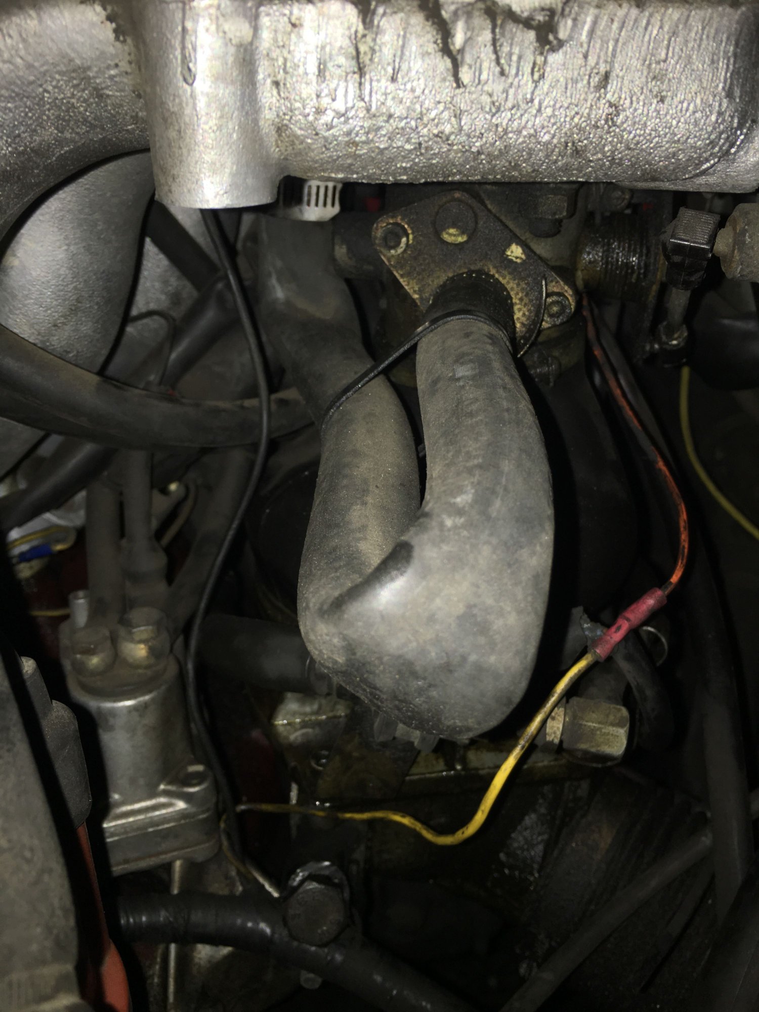

I'm wondering what this 'fix' is:
As you can see its right below the intake manifold. From what I can discern from the manual I have it seems like this should be where the idle adjustment screw/etc is? I'm assuming this being weirdly zip tied etc might have something to do with my high idle as it seems like this would change air flow/etc.

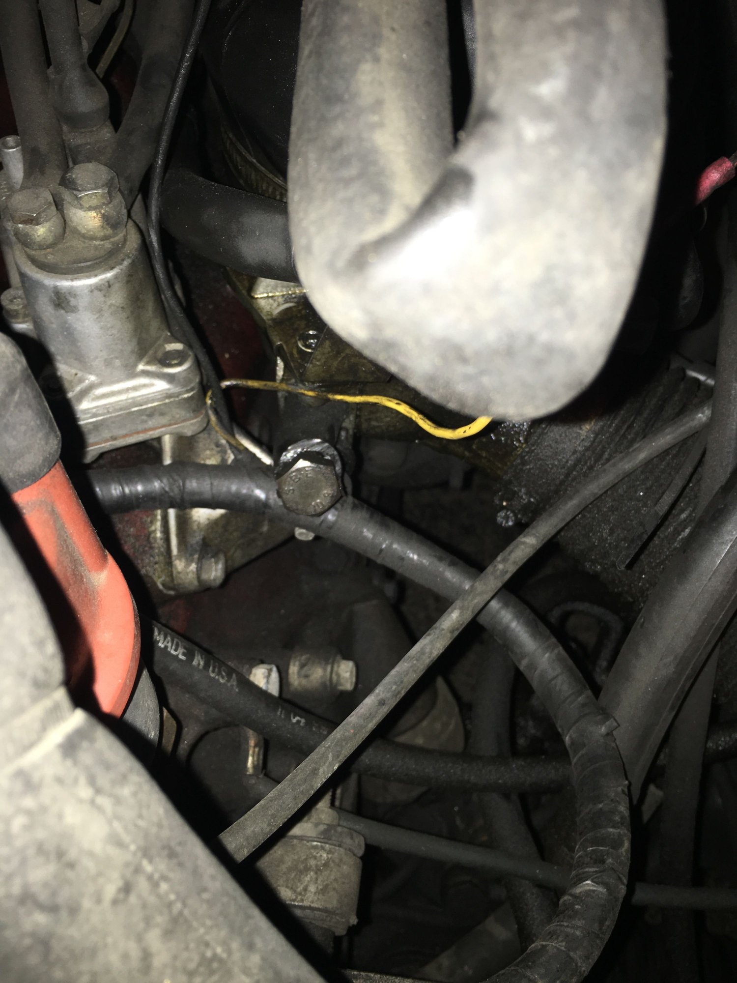

Off of the air flow sensor I discovered this hose coming off the front with a screw in it -- I'm assuming to 'seal' it... what is there? Where should it be going?

Do you have heat? The hose looks like bypassed heater hose... The bolt, not sure; '82 is not that familiar to me.
Old Jan 25, 2019 | 02:23 AM
that bolt looks like its on a vacuum fitting on the throttle body?

Yeah. The bolt seems to have been used to 'plug' a vacuum fitting. I'm wondering if the terrible streets and potholes of Philadelphia loosened that 'fix' and now that is leaking air -- whereas before the bolt plugged it. When I investigated it I found a bunch of mauled rubber from where the bolt meets the hose. Maybe when they first put it in there it ate up some of the rubber and formed a good seal.

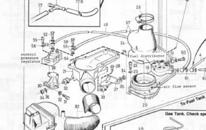

So did some digging and found this:
Which seems to line up perfectly with the hose with the zip tie on it. Any ideas about that?
At the front of the bottom of the air flow sensor appears to be the hose that is plugged with a bolt. Any idea what that is? I can't find any information in this manual to tell me what that part actually is.

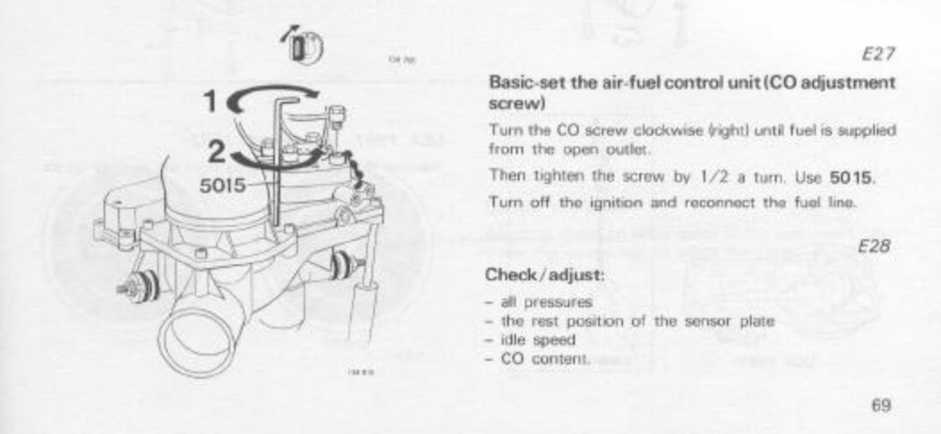

And:
I'm still not finding this idle adjustment -- I'm really confused by that.
Tomorrow I'm going to try to do some more digging and see if the CO screw exists.

yours is a 82? thats the very last year of the CIS volvos were uS imports, as far as I understand.
I believe there are two versions, one has the aux valve you show above, thats turned on to boost things when the engine is cold, and then shuts off, using a thermoswitch timer. there is no idle regulation like there is on later cars.
the other version has a fancier idle air regulator in place of that aux air valve, these do a better job of idle control. i would expect a US model 82 to come with this setup.
yours apparently has been hacked, and by bending the tube over, its effectively closed off.

the idle adjustment is that **** where the arrow is pointing on your last picture, under the front corner of the intake manifold.

I'm not seeing anything there where it should be according to that diagram.
If that were the case wouldn't it be visible in this picture?
And I mean that as a serious question -- because I'm honestly a little confused. Things aren't lining up 100% with anything I'm finding.
The top of that photo is the intake manifold.

whats that on the far right edge of the photo just under the manifold box ?
I'm wondering if that bent/pinched hose *is* your idle air, which should have been connected to the air aux valve AND the idle adjustment valve, such that the two of them let air bypass the throttle body....
That is exactly what I was wondering.
Tomorrow I'm going to do some digging and see what that is on the far right - but that bent replacement hose seems like it should be the idle and aux air valve... I'm gonna do some more poking around.
