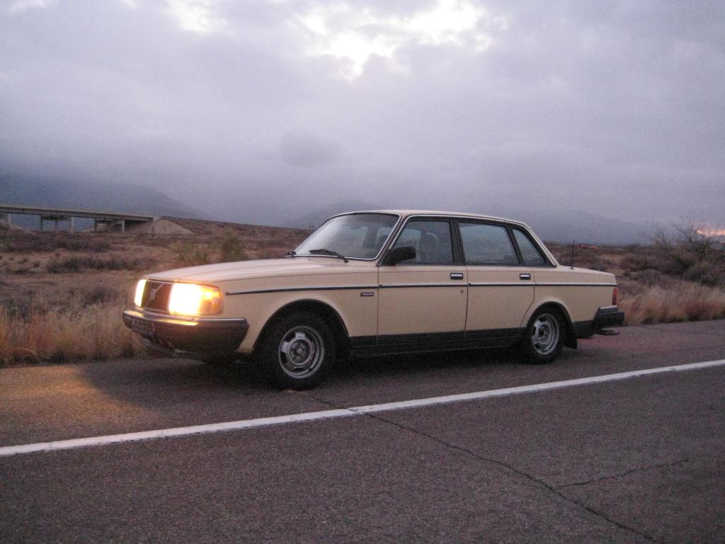

p.s. pic is from a doggie pee stop somewhere in New Mexico.
