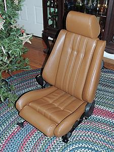

Old May 17, 2018 | 04:59 AM
MSGGrunt's Avatar
Joined: Feb 2018
Posts: 140
From: Western Massachusetts
This is the "kit" that I used to recover my BMW sport seats. And this was my first time doing upholstery work.

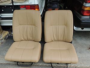

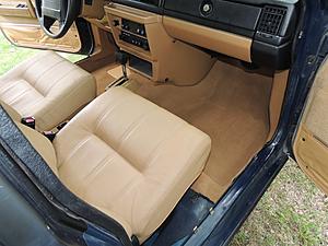

Old Jul 6, 2018 | 06:36 AM
MSGGrunt's Avatar
Joined: Feb 2018
Posts: 140
This is how the front seats came out using the kit from Lseat.com. I am very happy with them. The wrinkles are not as bad now that the seats have been sitting in the hot sun for a week or so and have been sat in.
The rear covers are finally done and on their way. More pictures to follow once I get them installed.
