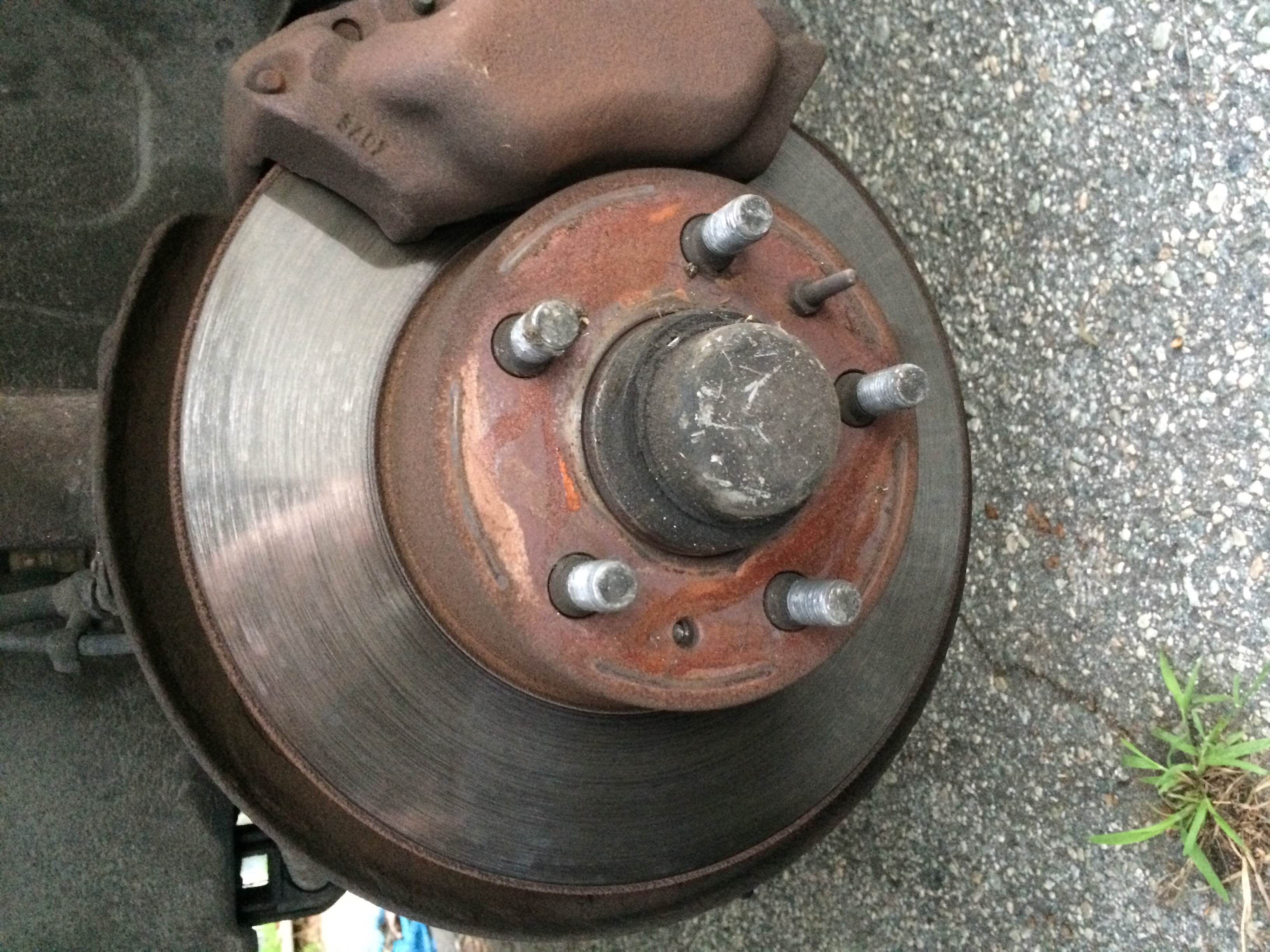

What do the rotors look like.

Here are pics of the rotor, this isnt the one the making the scraping sound but it looks very similar. I can post pics of the one making noise in a few days.
Attached Thumbnails Volvo 240 Braking Sound-img_7068.jpg   Volvo 240 Braking Sound-img_7061.jpg

if a caliber is 'hanging up' and not fully retracting, the pads can make scraping noises. this usually accelerates wear on one pad
i'd probably jack up the wheel you suspect, and spin it by hand while feeling and listening for the source of the noise.

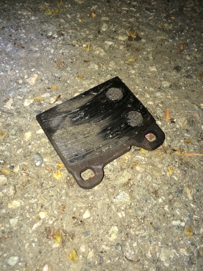

Today I replaced all my rear pads. Each had about 30% left except for the outer rear right pad. This is the one that was causing the scraping noise and has now left tons of deep scratches on the outside of that rotor. It looks like I'll need to replace the rotor now but I'm worried my problem isn't fixed.
As of now I'm having no noise issues, but considering just one pad was worn down to metal I'm worried the caliper may have an issue. When I was taking out the old pads and pushing in the caliper pistons, some leakage occurred. Is this normal? this didn't occur on the other rear caliper. Could I possibly have issues with brake fluid? I'm definitely going to order a new rotor, but I don't want to buy the caliper yet until I know that's what I need. Any suggestions?
Attached Thumbnails Volvo 240 Braking Sound-img_7120.jpg   Volvo 240 Braking Sound-img_7116.jpg   Volvo 240 Braking Sound-img_7089.jpg

Leakage, from where? There shouldn't be any! But you seem to have a bad (frozen) caliper that should be sorted.
The leakage is coming from the caliper pistons. Do i need to get a whole new caliper or can I fix it somehow?
Old Mar 24, 2016 | 09:32 AM
lev's Avatar
lev
Posts: 4,540
Likes: 137
You can rebuild it, buy new, buy used, etc. I wouldn't rebuild it myself, the cost of the kit is as much as getting a whole different caliper. Calipers are cheap for these cars.
