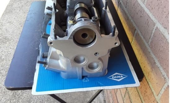

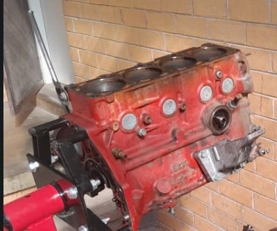

A "core plug" usually refers to the casting plugs (used in manufacturing) found in cast iron blocks. In the b230 block picture below you see 4 plugs on the exhaust side of the block and none visible on top of the rear of the block. There is a core plug hidden behind the flywheel - which would require trans or engine removal to get to. If a core plug leaks you will lose all of the coolant and the engine will over heat. Did that happen?
There is a cam plug used on the B230 240 head where a distributor covers that space on the 940s. That metal/rubber coated plug can pop out due to higher than normal pcv pressure as another has mentioned. When that plug pops out - oil will leak profusely out that open hole. Did that happen?
A cam plug is a simple repair. You will need a new cam cover gasket, a new cam plug and a couple of drops of silicone to seal the cam cover gasket where it has to bend.
That does not explain - "misfires, popping sounds, loosing power, stalling, bang and a puff of smoke".
Those symptoms could easily be caused by running the engine out of oil until it seized/self destructed (from a missing cam plug) or frying/overheating the engine (due to lack of coolant).
The solution to either of those is much more than just a "core plug".
Sorry for your loss.

Never heard of a core plug. If you look at the block that Honk posted you'll see there are not plugs between the block and the firewall. Given this, I assume that you mean the cam plug a it is between the head and the firewall. That is what I was referring to in my first post. If this blew out you would see a lot of oil in your engine compartment up by the firewall.
If it were me I would check the flame trap to see if it is clogged. I would also perform a compression check. You have a lot of miles on your engine and the compression may be down which results in blow-by around your pistons. Was there any oil left in the engine?

Unfortunately there are 2 smaller core plugs on the back (and front) of the b230 head.

Yeah - what still isn't clear on this thread is whether it was a freeze plug that blew out or the cam plug. The cam plug goes where the hole is shown on the picture of the head. I haven't seen a freeze plug blow out before. I have seen leaks in them due to rust. Cam plugs blow out all of the time - especially on high mileage engines.
