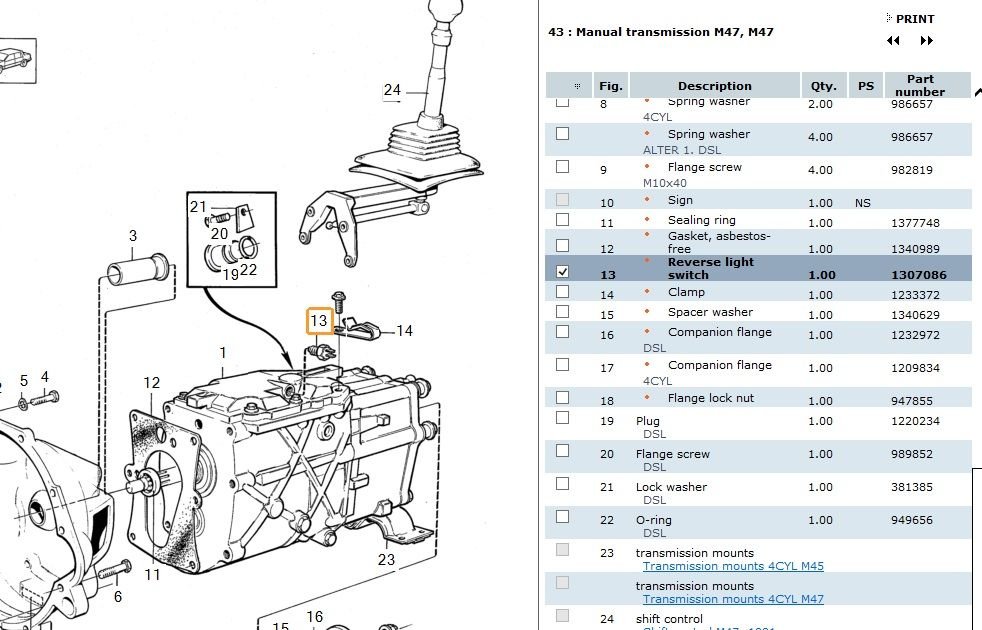

I'd check the wires at the reverse light switch - at this age the insulation may be gone and the wires could be shorted - causing power to go the the reverse light bulbs.

The wires on the reverse light switch aren’t currently connected, and the lights still come on.

If those wires are still attached to the #14 clamp on the top of the trans - lack of insulation can cause that.
Or the reverse lights plug into the harness on the left? side of the trans tunnel - pull the carpet back and unplug the subharness there ( from the switch to the main harness.)
Or - take the fuse out.
