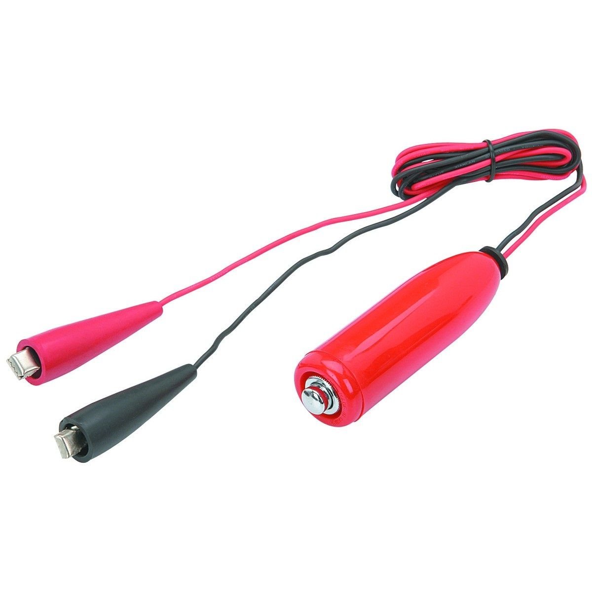

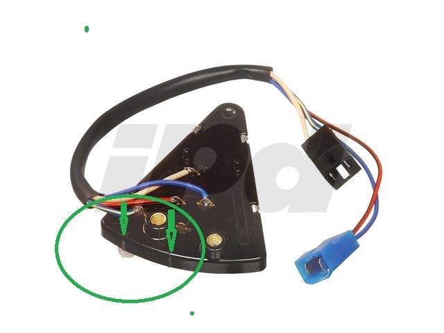

Have you tested your "new" starter by using a jumper wire or your $12 harbor freight remote starter switch to send power directly to the small terminal on the starter solenoid? And checked to make sure the NSS is lined up correctly when in park and neutral, white pointer is hooked onto the shifter and aligns in park and neutral with two areas illustrated by the green arrows. (2 screws remove the shifter cover)

As far as I can tell, it appears that its lining up correctly. I jumped the starter on the car and it cranked.

So i bought the jumper button you suggested and it cranked. Still no spark, so I ran some wires to fix the ground issue that I had noticed on the crank sensor before and it cranked, sparked then started and ran. Im assuming that this crank sensor and the NSS switch share a bad ground at some point. Agree? What would you think would be the easiest repair? I dont mind bypassing the NSS or even running this wire from the starter.
