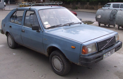

Good to know about the 300. I only saw some in Ukraine, but didn't get the chance to look at them up close. Here are some pics I took and really have no other purpose for having other than putting them here.
The Amazon was from before they started the new model numbering system when they released the 140s in 1966. The 164, 142, 144, and 145 comprise the 100-series (aside from a couple one-offs there were never any 162s or 165s) The 164 looks very different from the 144 from the front, but the rest of the car is exactly the same. I've always liked how little they changed things over the years, a door from a 1966 140 will fit a 1992 240. In fact if I found some front doors from a 140 I'd replace mine, I miss having wing vents, and the mirrors and door handles look cooler.
The 300s unfortunately were never really considered good cars, Volvo's tendency to overbuild things is excellent in a family sedan but made for a rather heavy hatchback that didn't handle any better than a family sedan. The car was originally meant to be a partnership between DAF and Volvo and thus was built in the Netherlands, but Volvo acquired DAF in the process of designing it. The engine came from neither of them, they used a 1.4 liter from Renault. It did have one cool feature though, the transmission was in the back. Unfortunately for the first four years the only transmission available was a DAF-designed CVT. After that they started offering Volvo engines and Volvo manual transmissions and they became a little more popular.
