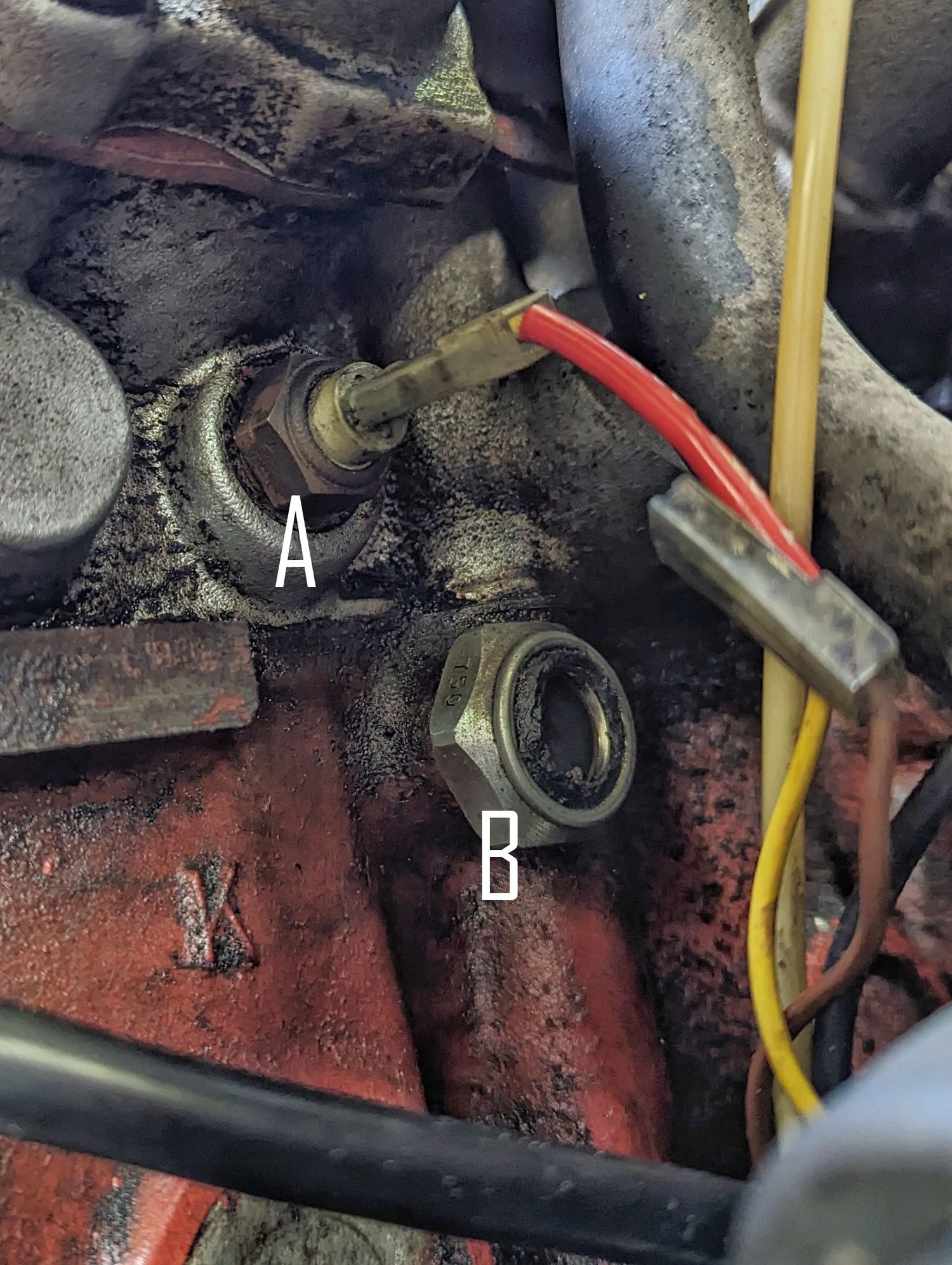

As I was preparing to test a couple things related to fuel pressure, I came across this potential culprit. I believe "A" to be the coolant temp sensor for the dash gauge, but "B" has snapped off completely (second photo is the rest of it in my hand.) Searching the parts sites, I see a two-prong temp sensor that sends a temp to the ECU for the fuel injection system but that sensor does not look like this one, and it's just one wire. Anyone know what "B" is? For reference, it's the LH 2.2 from 1988.

A is your temp sensor for the gauge. B is the early style single wire knock sensor. Car will run fine without it. Later style is 2 wire and clamps against the block.
The temp sender for the fuel injection is installed in the head near the #3 intake runner - Not too bad to get too. Probably a 1332396. If you replace it - make sure the new one is the same color as the old - there are blue ones and black ones. They do not interchange. I would certainly look closely at the temp sensor for the fuel injection - given the condition of the knock sensor. That temp sensor tends to melt when the cars are overheated - the single wire one for the gauge don't seem to melt at all -
I would still check rest pressure - that's a common cause of hard warm starting if still having problems. When engine is off the fuel pressure is held on one end by the check valve in the fuel pump, and the other end by the fuel pressure regulator.
If you have a new pump with a new check valve - conceivably you could test the fuel pressure regulator by clamping off the return line fully (as long as that hose is still flexible enough to survive that treatment! )
Wait the amount of time you usually suffer from hard warm start and try it.
