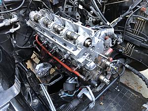

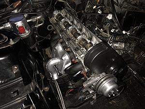

So I ordered an engine gasket kit from Fcpeuro or Eeuroparts...one of those guys and all the gaskets fit except for the valve cover gasket...it was too wide and not the right amount of holes.. so I went to O’reilly auto parts and they pulled one for me according to he Year make and model of the car and I get it home and it’s the same thing.. what am I missing here?

what year 240? B230F engine, or one of the earlier ones (B21F, B20F, etc) ? ok, I see ABS plumbing there, so its gotta be a B230F, huh.

Make sure it's the right way around then fit it over the cam shaft humps
I'll bet you after it's held in place, it'll be exactly the right size.
I use some RTV to hold it in place on the head before fitting the cover, otherwise it's a pain to line up
