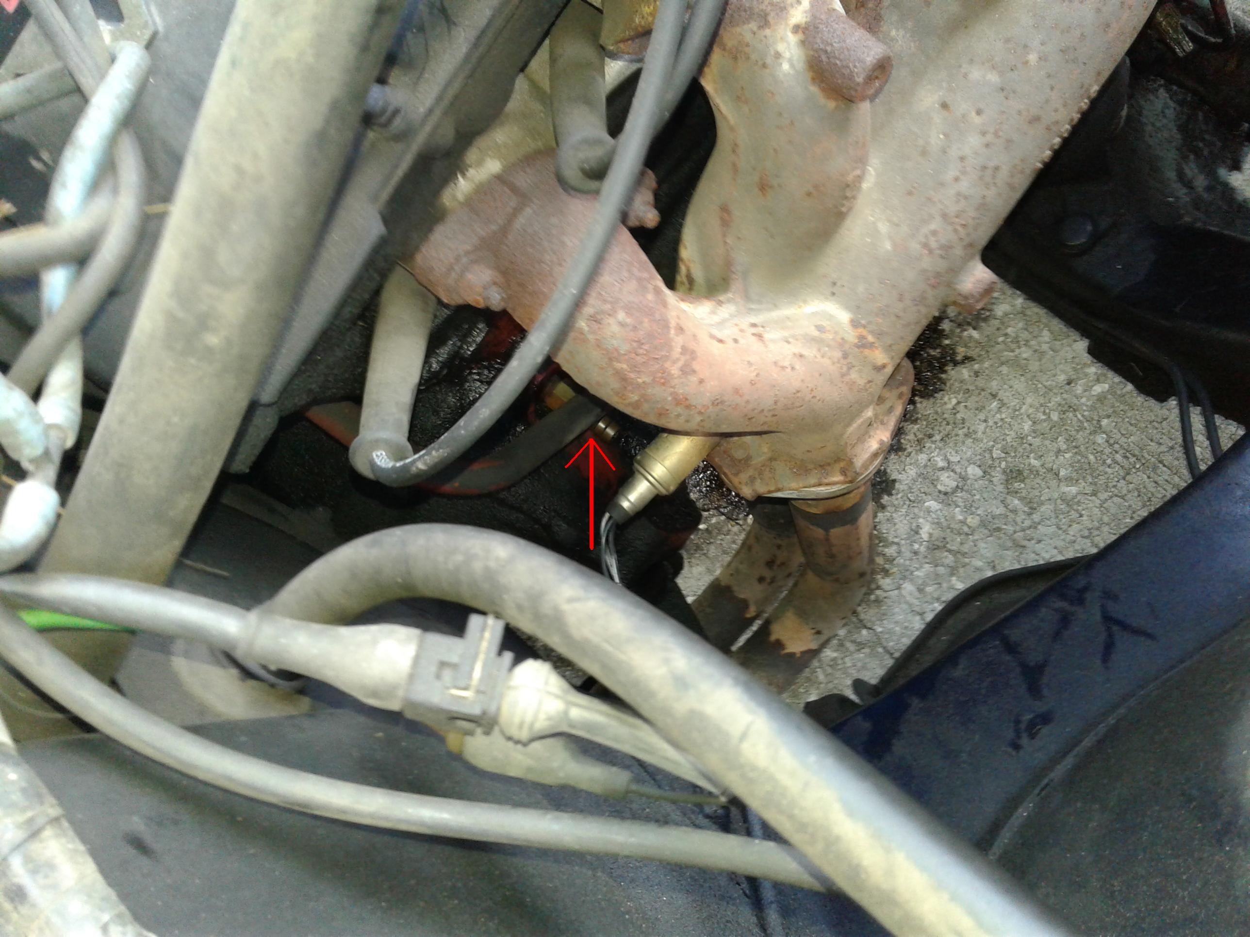

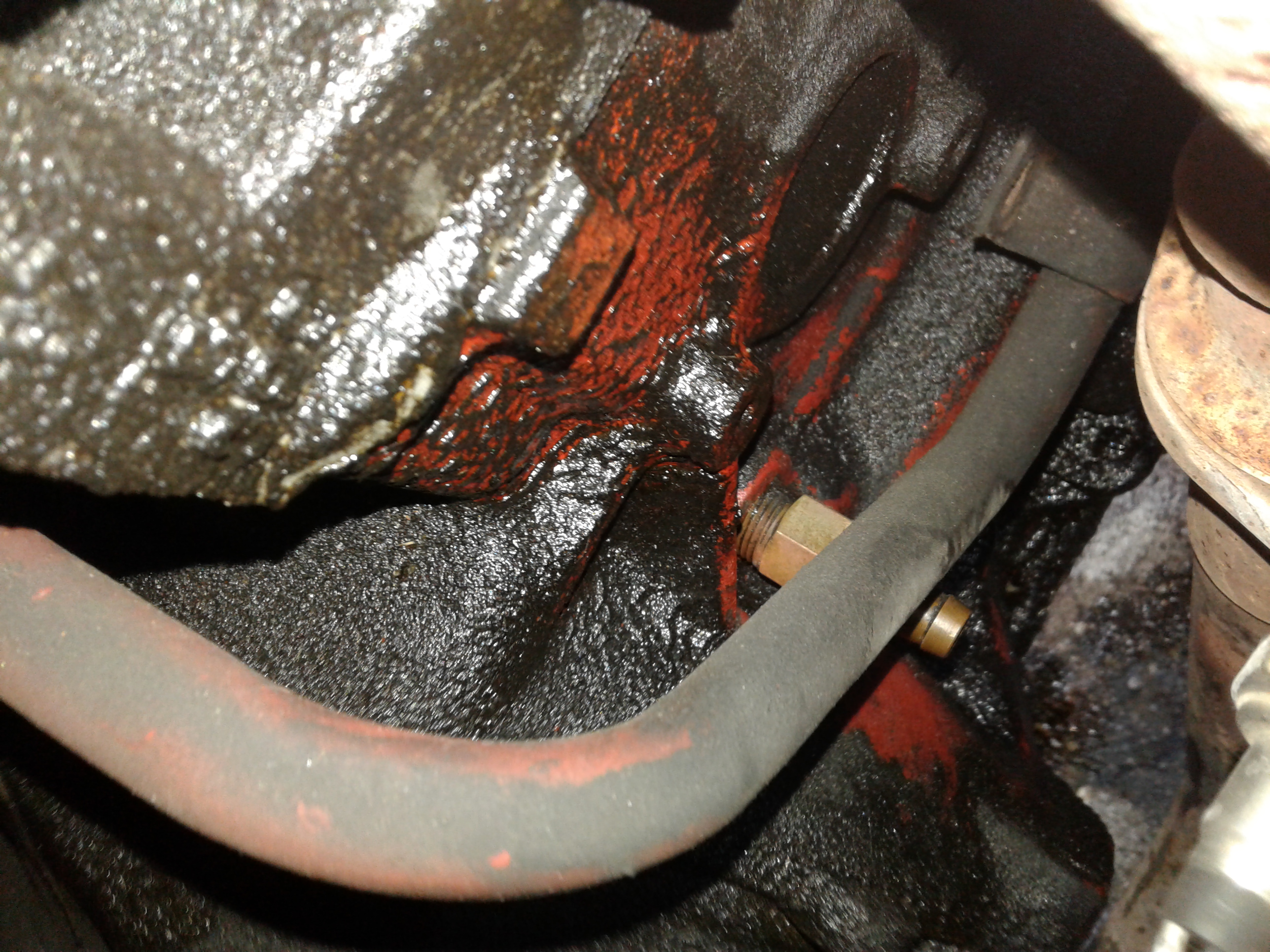

My Volov is leaking oil and I think I found where, but I am not sure what the part is...Its on the passanger side of the engine in the bottom corner of the engine, kinda behind the o2 sensor.
Does this part have to be screwed in all the way?

that is the coolant drain, its used to drain the last coolant out of the block after draining the radiator. its a sort of valve, you turn the small nut to open/close it while using another wrench on the large nut to hold the base part fixed.
it appears the oil is leaking from well above it, probably the valve cover gasket, maybe the head gasket, hard to tell for sure from those photos. I would spray that down with Gunk foaming engine cleaner (when the engine is *cold*), let it soak in, then wash it off with a garden hose, and take a short drive, then see where the oil is coming from.

Thx. The edges on valve cover are clean as far as I can see. But is there anything that can leak on the back side of the engine, in front of the firewall?
I will have to clean it and try that,but I am just afraid I will spray something wrong and mess it up.

valve cover gasket leaks would come out from the gap between the valve cover and the head. the top of the valve cover would remain clean... leaks always go down, and with the wind towards the back. the whole back corner of that head looks oily.

in your first picture, the whole side of the block looks oily from the #4 exhaust header back, and dirty, like its been oily for a while.
