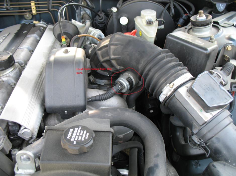

About a month ago the check engine light came on. I used the OBD:
Position A1: 1-1-1
Position A2: 5-1-2 (see photo below)
Position A3: Nothing
Position B1: 1-1-1
Position B2: 1-2-2 (see photos below)
Position B6: Nothing
I know that 1-1-1 mean "all clear" but I am not familiar with getting "nothing" by which I mean not any blinking lights.
Also with the key in position II to check the OBD I noticed a constant humming (sounded like a bee) as if lot of current were going through a Bosch part between the air mass sensor and the engine. I looked up the part number (Bosch 0 280 140 522) and found that it was the Idle Control Valve. (Photo below)
I disconnected to get a better look, this made the humming stop, because it had no current, then when I plugged it in again the humming did not continue. I put the key back to position I, then back to position II and the humming came back. Here is a link: 84 1984 Volvo 244 Idle Control Valve - Fuel Injection - Bosch - PartsGeek
Three questions:
What do the codes mean?
What should I do to fix the codes?
Is it normal for the idle control valve to hum like that?
Thank you!

Yep. I have posted my online manuals a few times here:
A2/512: Short Term Fuel Trim Lower Limit
B2/122: Speed has not exceeded 35 km/h or no vehicle speed sensor signal

Code A2/512 points to excessive back-pressure, i.e. clogged cat.
