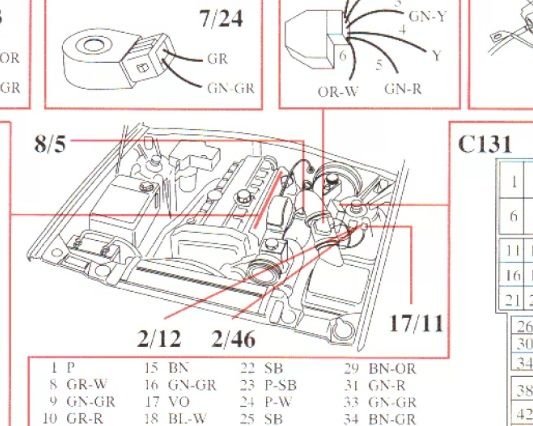

Or there are two relays under the hood that power the injectors (2/12) and the coils (2/46) - could easily have a cracked solder joint in either one. There's power to both injectors and coils all the time when the car is running - and the control unit provides a ground to fire the coils and injectors when needed. There are 2 ignition modules on that engine - each fires three cylinders.
