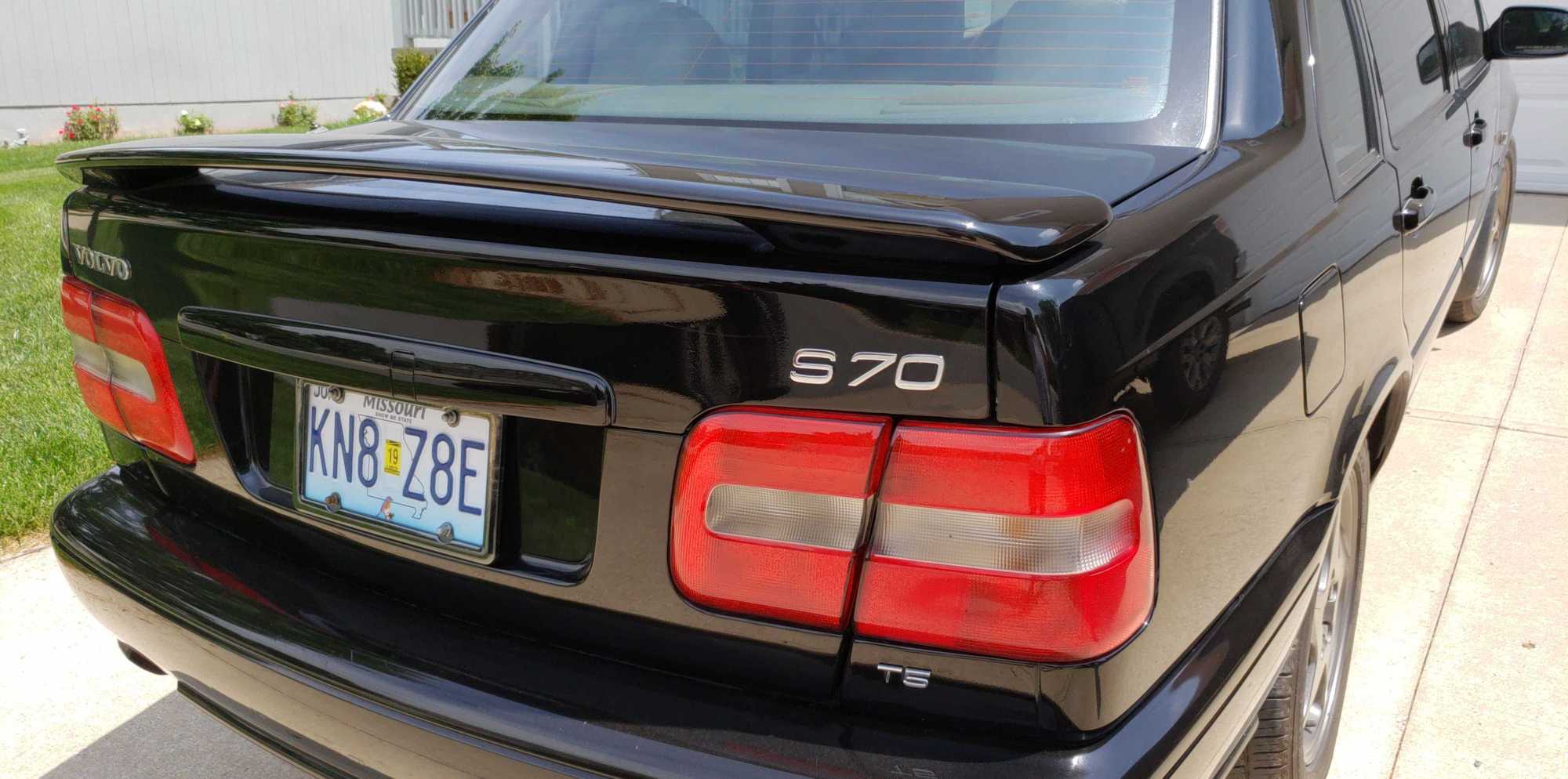

Old May 17, 2018 | 10:10 AM
Brettmcox's Avatar
Joined: Feb 2018
Posts: 23
Old May 17, 2018 | 11:09 AM
firebirdparts's Avatar
Joined: May 2012
Posts: 1,988
Likes: 52
From: Kingsport, TN
Nice! I have a 1998 T5 manual and I absolutely love it. Too fast for a new driver, ha ha. The 99's have a electronic throttle and I believe you are correct about VVT on one cam. That was the first year for both those features, and in fact the 99 has heavily revised computers that are better to work with in native Volvo scan tools. The 98 is simpler. That said, I think the 1133 is the O2 sensor, and I think it's the front, but you'd like to know front or rear. At the age of the car, I would think it's just died from being used up.
