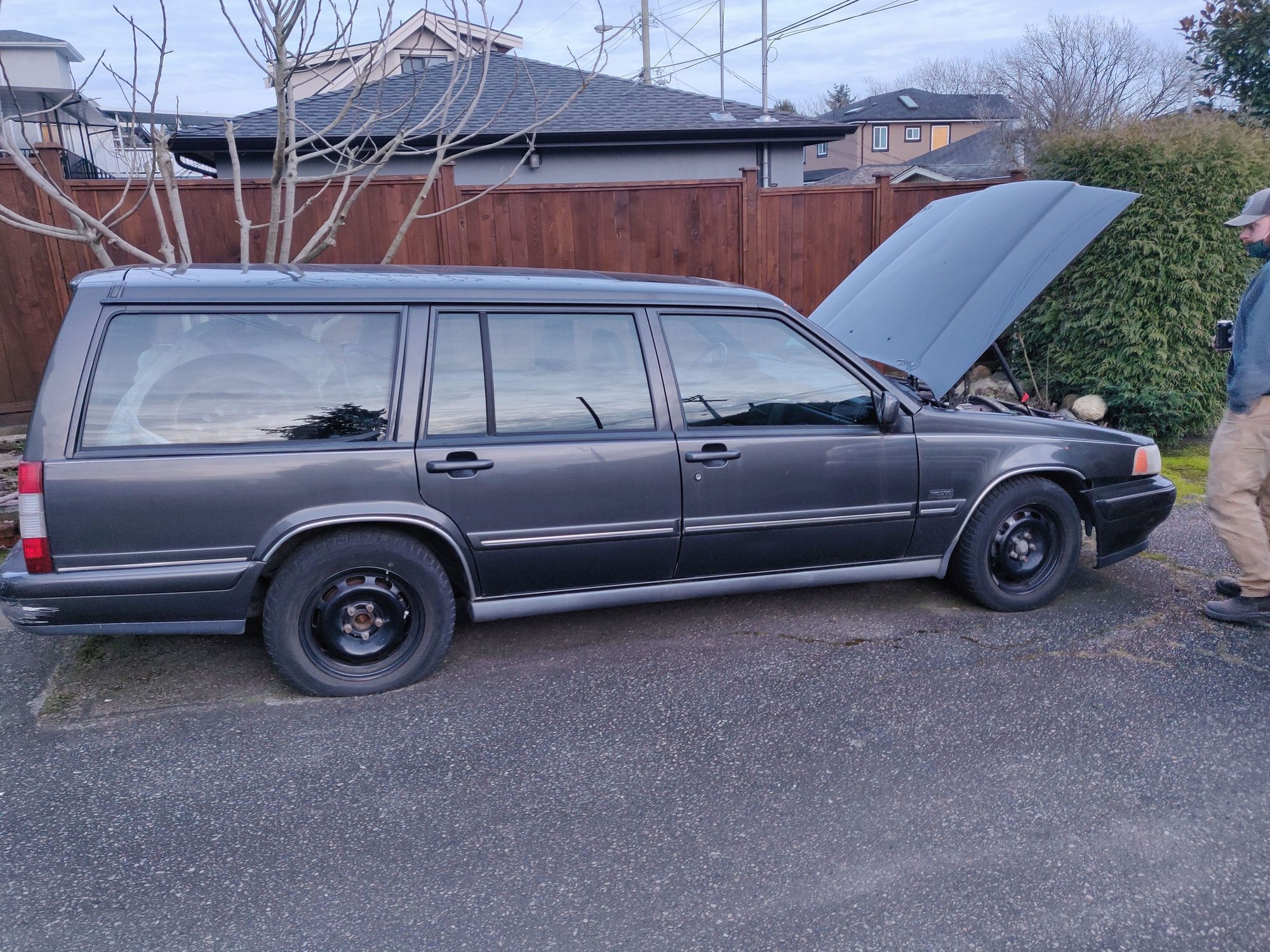

Hi everyone! I'm not a Volvo guy (GM guy), but I'm trying to help an elderly neighbour with her mint 1995 Volvo 960 wagon, with ~100,000 miles.
It has been sitting for 2+ years in a very humid climate (Pacific North West). The car apparently has been fired up a few times since it was parked, but she doesn't have any memory of when.
We put a new battery in, and tried to fire it up. Nothing. There is no cranking. We have the following:
  • Fuel pump is priming and kicking in
  • All lights work. Signals, hazards, headlights etc.
  • Auto door locks work with the fob on and off, but no beeping when hitting the lock multiple times
  • Only fuse we've found that was blown was the radio
  • I've swapped J relays around from things like Air Pump to Ignition system, with no luck
  • There are 0 dash lights when trying to crank, which is concerning.
I've heard of faulty neutral safety switches, and tried manipulating that a bit, with no luck. The biggest issue I see is the lack of dash lights. I'm wondering if the ECU is fried? Isn't there safeguards in place to stop that from happening?

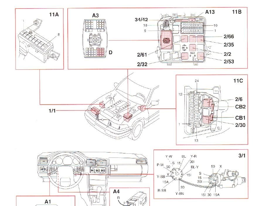

That car has a starter relay, # 2/35, you can pull that relay and jump terminals 1 and 3 - but unless the neutral starting switch is good (#3/40) power will still not go the the solenoid to engage the starter. So check for 12v at terminal 1 on the starter relay - and if you use a jumper wire to terminal 3 - the starter will engage, unless the neutral starter switch has a problem. If so, try to start the car in Neutral rather than park.

[QUOTE=hoonk;495698]That car has a starter relay, # 2/35, you can pull that relay and jump terminals 1 and 3 - but unless the neutral starting switch is good (#3/40) power will still not go the the solenoid to engage the starter. So check for 12v at terminal 1 on the starter relay - and if you use a jumper wire to terminal 3 - the starter will engage, unless the neutral starter switch has a problem. If so, try to start the car in Neutral rather than park.
