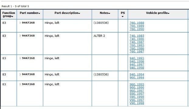

I have a 1996 960 wagon that needs a new driver's side door check. I don't see any online and was wondering if the checks from a v70 or V90 would work?
Thanks for any input you may pass my way.
Old Sep 8, 2022 | 01:40 PM
If you are asking about the check strap - which is a spring and part of one of the door hinges -that hinge is the same on the cars listed below.

Thank you very much. This is just what I was looking for.
