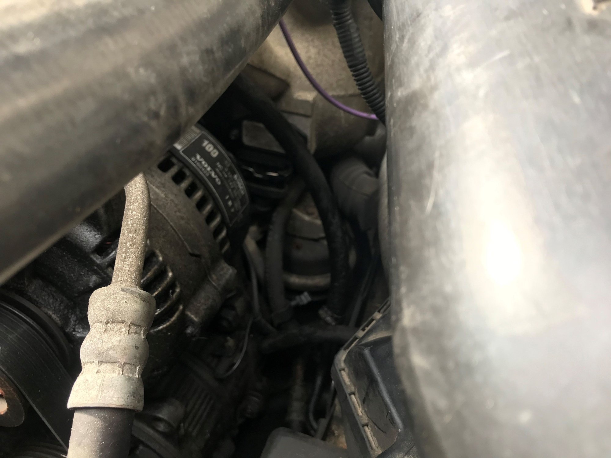

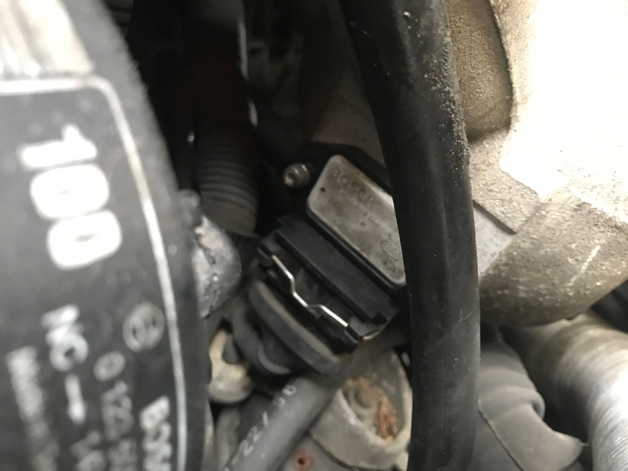

Old Nov 11, 2020 | 02:08 PM
CoOlCat's Avatar
Joined: Aug 2019
First two pictures are of the odd 1,3,5, right behind the alternator facing the front of the car, the last picture is the even 2,4,6. which is directly on the other side of the other, i took the picture from underneath my 1997 960.
Old Nov 11, 2020 | 02:10 PM
CoOlCat's Avatar
Joined: Aug 2019
From me searching for these locations for 2 days online, these are the first pictures of their locations to be uploaded to the net!
