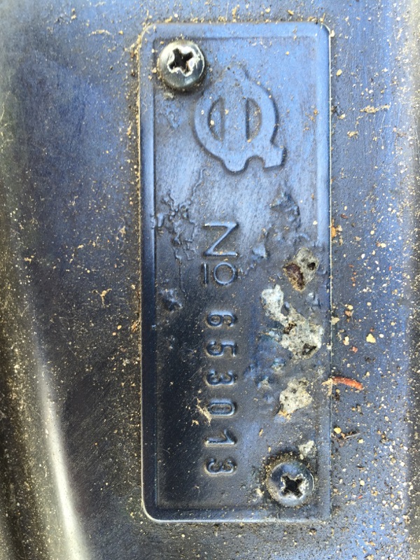

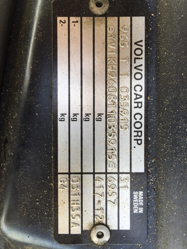

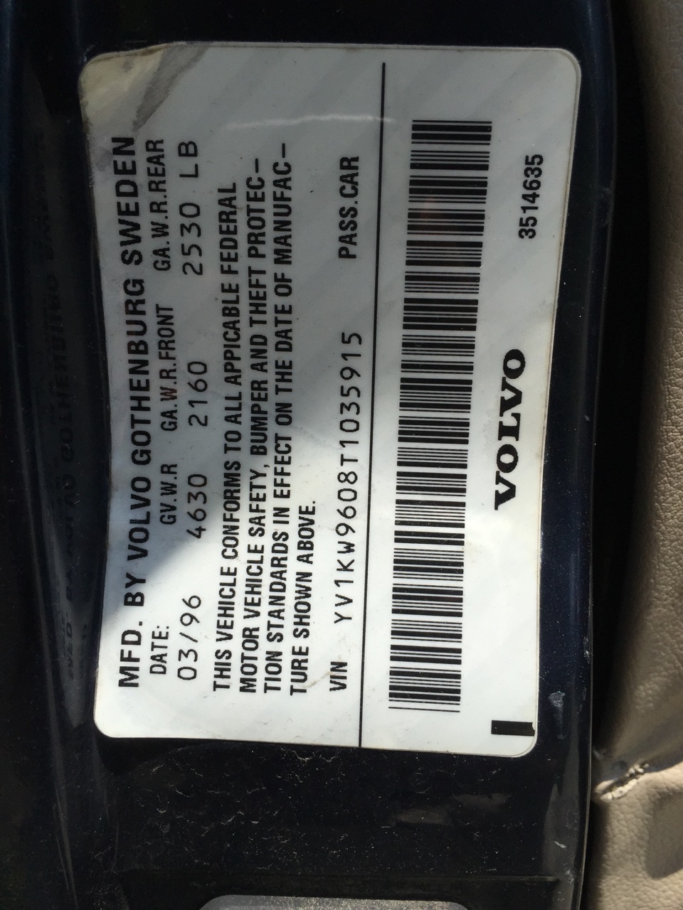

Can you show a photo of the data plate on your car? This will allow one of us to find the variant that you should have.
Old Jun 25, 2015 | 11:51 AM
jands's Avatar
Joined: Mar 2015
Posts: 153
I'll post the plates tonight. My tie rod is about 240mm all the others are about 270-285mm.
Last edited by jands; Jun 25, 2015 at 01:57 PM. Reason: typed 210 instead of 240...
Old Jun 25, 2015 | 01:56 PM
jands's Avatar
Joined: Mar 2015
Posts: 153
here are my plates.......see attachments.
Also i found this part number :Volvo: 9140 788 this appears to be 240mm long......so it would be the about 3in shorter i need......is this correct?
Attached Thumbnails HELP!  Cant find correct inner tie rod ends-img_0013.jpg   HELP!  Cant find correct inner tie rod ends-img_0014.jpg   HELP!  Cant find correct inner tie rod ends-img_0015.jpg

You should have the TRW rack because this is a '96 model.
Check your part numbers to see that you got the right ones? I would get 9140788 as shown as #3 here. Older cars have a different TRW rack!
