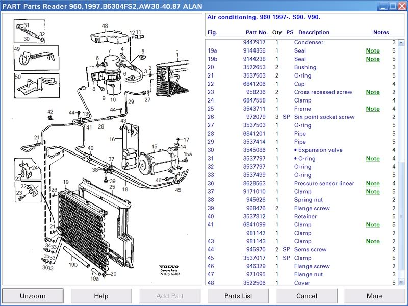

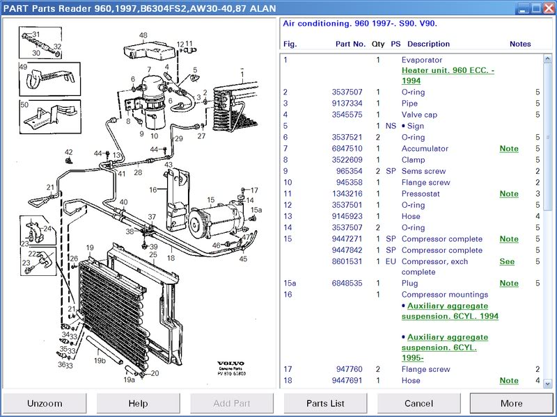

I have a 97 960 and i need a new AC line but dont know what the part number is as the part was thrown away before i bought the car. I needtheline thatcomesoff thereciever and goes to the condensor( this is the low end side withtthe port for recharging)as well as the line that runs from the evaporator to the condensor(the whole thing complete with expansion valve). does anyoneknow these numbersand where i can getthem from with out having to resort to the dealer????

Im uploading images.
Here you go if you can't see a part # let me know.

THANKS so much... thats a great help!!! I was able to find everything i need!
