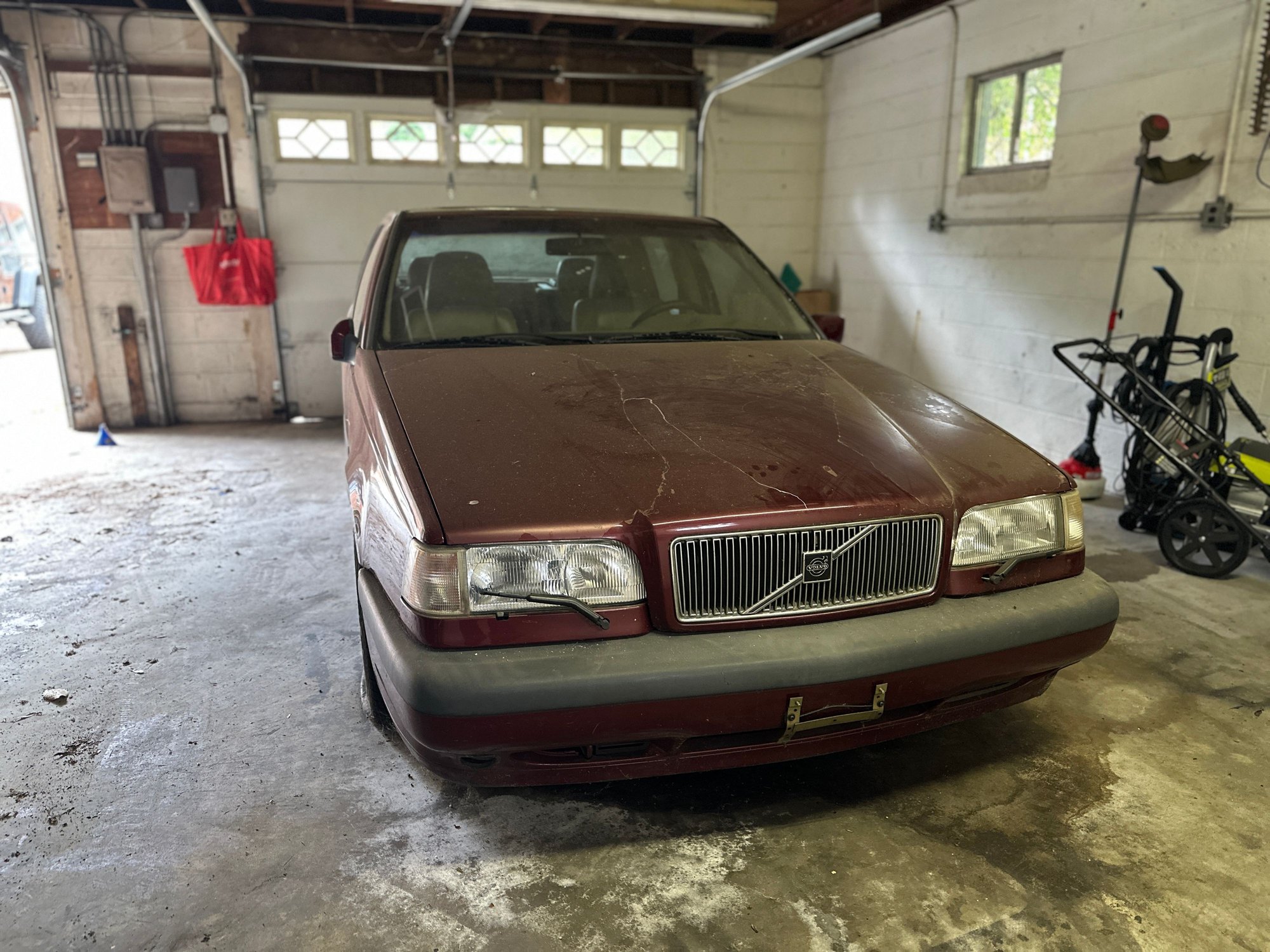

During high school, I bought cars from my local auto auction to flip. One Saturday I had work and gave my father $750 to pick up a specific car on my behalf, a 2001 Mercury Grand Marquis. About 8hrs later, I arrived home to meet this automatic 1997 Volvo 850 Base with 72,000 original miles.
Since owning it we have never been able to get it started, I’ve since moved 600 miles away and my parents want this thing out of their garage understandably.
My question to the forum is: what can I do with this car? It may not be worth keeping financially but even if I got it running it would be a good secondary car for either myself or my parents to have around. Ideally, I’m thinking engine swap to a T5 or some similar sleeper build. I haven’t had the best luck finding a Volvo Mechanic looking to work on it in the state of Maryland.
Over the years we’ve had a few look at it, the car cranks but won’t turn over. I’ve been told to replace the distributor cap a number of times which has yet to bring a different outcome.
If anyone has been in this situation feel free to share any insight.
