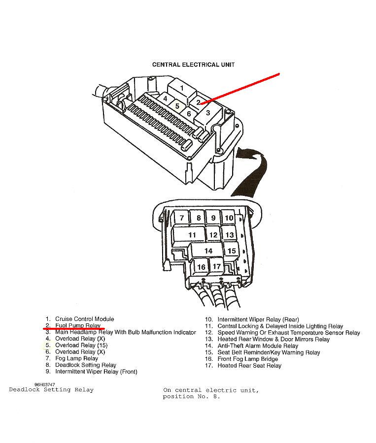

I hate no-start & stalling troubles.
See attached FYR. Also check ETC (Engine Coolant Temp) sensor.
