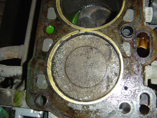

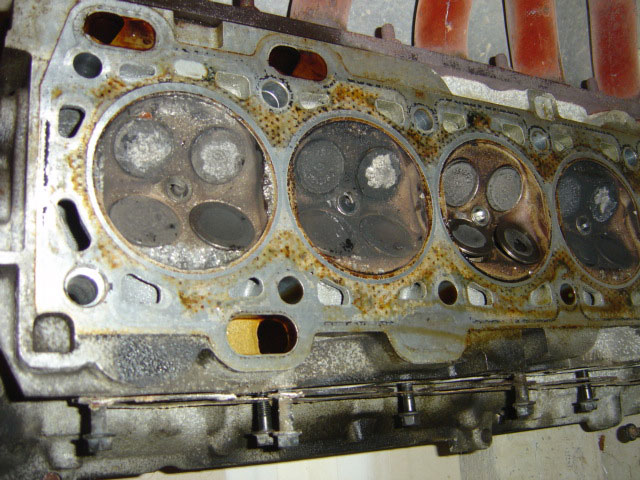

Well, it has been a long time since I lasted posted and I like to finish up my threads. So I finally got down to tearing apart the volvo.
Here is what I found. Talk about bad luck.
So, bent valves in #3. Now, can someone tell me what is going on in #1? It looks like something was bouncing around in the cylinder and chewed up the piston and the head. All the cylinders have these marks, though not as severe as #1. Anyway, it looks like I'll be looking at another engine.
