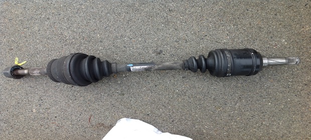

Hi there, I just purchased a driver side front axle replacement. I have a blown out wheel bearing and boot or it may be called the cv joint at the wheel end of the axle. Anyhow, I'm replacing the whole axle as suggested and as shown here in pic 1.

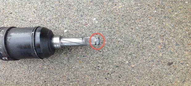

I cannot find any reference to the circlip removal at the transmission end of the shaft (shown in pic 2). I've checked the forum, my manual, and youtube. There's no reference to the removal of it.
Manual states to make sure it's fastened but nothing about removal. I have not delved into the car yet and my question is:
Is this circlip easily accessible from underneath the car?

the circlip stays on the shaft all the time. While the axle shaft is inside the tranny, the clip opens just enough to prevent the axle from coming out. There is no access while it's inside. There are different ways of removing the axle. In this video you would get an idea on how it's done. This guy is not working on a Volvo, but it's the same principle.
I suggest getting the car lifted as high as you can safely and securely on jack stands, not on a floor jack only.
If your handy, your going to save a couple hundred dollars of shop labor.
Hope this helps

His looks pretty good. If you just have to have a Volvo:
The only difference I saw on the other video is that to remove the joint with the "C" clip on it I use two large screwdrivers or medium pry bars and try to get them as close to opposite each other as I can. Remember you are prying against an aluminum transmission case so you want to be careful. I've done a lot of them and never damaged a case buy once in a while you can have a axle that just doesn't want to release and there is a tool for that you can loan from most auto parts stores.

Well here it is louiebay, you asked to let you know how things worked out.
Bottom line is: I'm back on the road with a quiet ride.
Releasing the spindle from the steering knuckle was quite the task. Once out I realized my bearing hub was shot. Had to wait a day to get it. Removal was difficult due to stripped star hub bolt. Had to remove stearing knuckle and grind one bolt head off. Had to wait another day to locate and get new bolts. Got those today and all went well after that.
