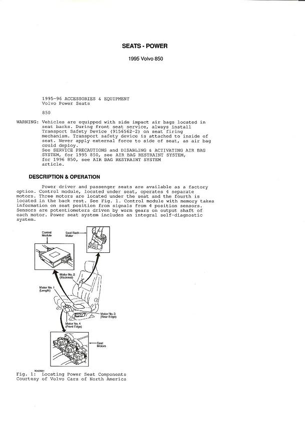

I could not verify a fuse that is dedicated to the front driver's seat. Try inspecting the fuse #26 & 33. The component #38 I circled seems to be a circuit breaker for the driver's seat so you may want to check that as well. Also, visually check & wiggle all electrical wires attached to the power control module under the seat. If not the control panel may be bad; it is held onto the seat by 3 screws from the inboard side. Check the wiring/connection between the control panel and the control module, which seems to be the culprit.
Wait for alternatives from other members in case if this didn't do any good.
