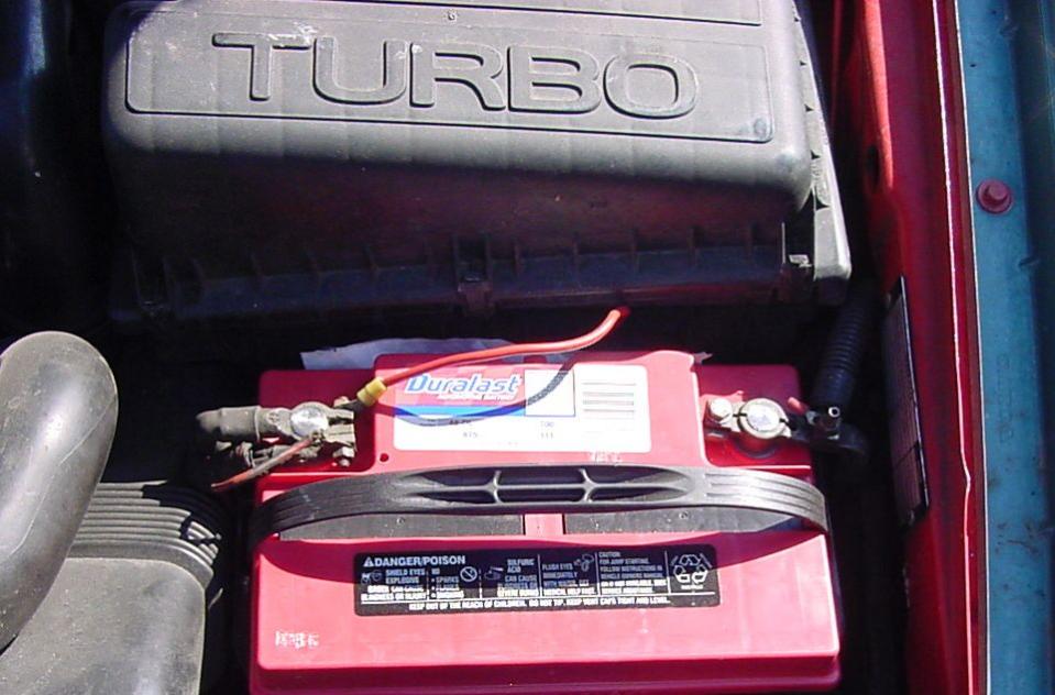

If you ever need to replace the battery consider getting the bigger battery that fits the holder. The standard one is a "Group Size 47". The higher capacity battery is a "Group Size 48" with more reserve and cold cranking amps. It's cheap insurance and a must in colder climates, added stereo equipment or just reliability. It bolts right in. In fact at Autozone the bigger better battery is actually 5 bucks cheaper and 110 CCA more power with the same warranty. On a sub-zero morning you can hear the difference in the cranking speed.
Search: 48dl | Battery | AutoZone.com
List: Battery - Automotive - 1995 Volvo 850 | O'Reilly Auto Parts
Doesn't matter if it's fleetfarm, sears or ..... it's still a 48.
This is a picture of the "48" in my car. You can't really tell the difference unless you put a 47 side by side.
