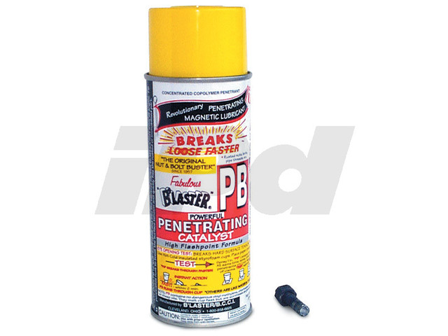

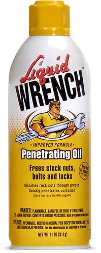

IMHO - Put the can of WD40 away. It's a dry lubricant and isn't a good choice for this type lubricating situation. On a latch that is in bad shape I'll spray one day with a penetrating lube like PB Blaster or liquid wrench and follow up in a day or two if it's working properly with a sticky white lithium spray lube.
WD40 doesn't work it's way into a problem and even if it does it evaporates. That's why it's a good choice for wiping down a tool. Spray it on, wipe it off and you can handle the tool without getting your hand oily. But that same property is what makes it a poor choice for lubricating moving machinery or mechanisms that have contact points. Penetrating oils are liquid oils and don't evaporate. They seep into contact points and provide lubrication long term. White lithium is sticky and works great for hood, trunk and door latches as you can spray it in and it sticks to the contact points. The reason I'll use a penetrating oil first on a problem latch is the penetrating oil will seep in and loosen things up where the white lithium is thicker and sticker and doesn't "flow". The white lithium is for long term lubrication to keep it working smoothly and repels water.

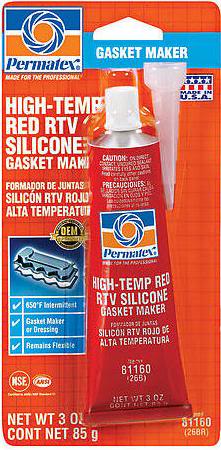

I'm sorry but it's like Permatex red. Somehow it was pushed on us and the marketing hype overtook the actual products capabilities. In case you didn't know the fumes from the "red" can actually corrode gasket material and metal inside an engine.
The reason Permatex doesn't pull it, they sell a ton of it as "we" think it's great stuff. That and the average guy isn't going to know the cause of a gasket failure due to the red RTV from any normal cause.
