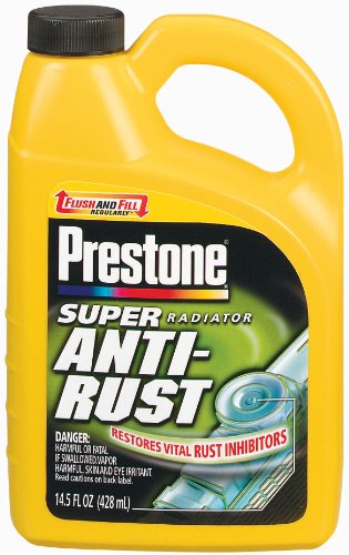

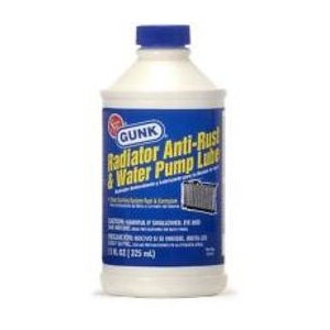

Originally Posted by guptash
2. Dexcool/Hybrid pH - 5.0 & Below Failed
It's an old thread but to make this clear, a neutral PH is 7. This cooling system is reading 5 or less which means it's pretty acidic. Acid eats metal so yes you need to flush and fill.
If the coolant isn't to old you can also add a treatment which puts back in the additives that break down over time.
I toss a bottle in every two years if the vehicle isn't close to flushing.
