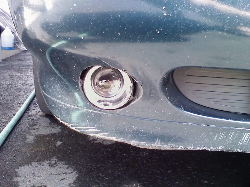

Alright thanks guys. I'll take pictures as soon as I can get a good camera to take pictures with. Everything works nice right now. I have a nice rainbow colored cutoff from the fogs

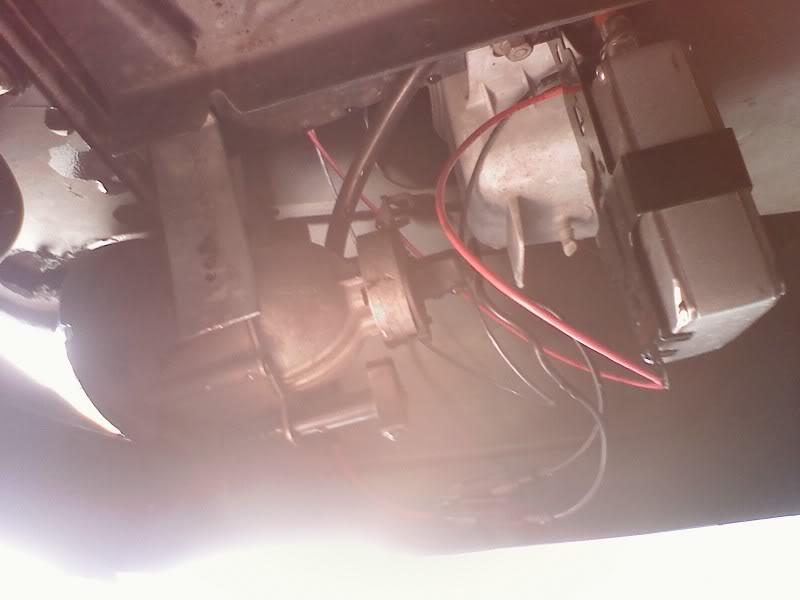

From the front
Mounting
Not the best, but they don't look horrible. Remember, these are off a Hyundai.
