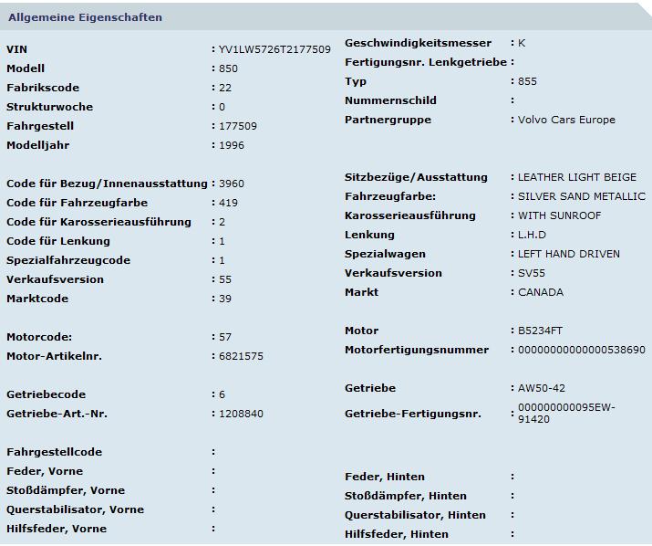

Got some additional infos about the car :
The car was initially produced for the canadian market.
It had leather light beige interior 3960, sunroof.
The T5 engine and Automatic transmission are also from the factory.
The color is silver sand metallic 419
Engine number 538690
Automatic transmission number 95EW-91420 (you can check them in order to see if the original engine and transmission are still fitted).
The only option which was ordered additionally was TRACS.
Hope it helps you
Cristian

Hey, great! Thanks for the info Cristian. Built for Canada, well, then it should be doing just fine over here in the 45 degree weather
The interior description is spot on, so I'll check those engine numbers as well. Probably going to get some engine mounts from Victoria when I'm home and a few other bits and pieces.
I think I'll get it for 1200 - 1500$ so that will help me to put another 400-500 into it to get it smooth again, then I will wait and let the creeping obsession over every other detail slowly consume me and my wallet.

Hi Again Cristian, that VIN check that you did for my 850 showing the market as "Canada" - what service is that? do you know of another web site that can tell me more about the history or ownership of the car? The reason I ask is that in a couple of years I will be moving back to Canada and would like to ship the car home. If it was made for Canada market, that will allow me to ship it but i need proof that the car matches the Canadian MVSA standards

Hi Mike
The information gave me a buddy of mine who has an official VIDA acount. With it he can enter the VIN and gets all the information Volvo has about the car, mainly the options the car had when it was purchased.
Market Canada means that the car was initially build for the canadian market, however it is possible that some changes occured afterwards due to the owner(s).
For example if a car is build for the UK market when you import it to Germany you need to change the headlights and make sure the cluster has KM for the speedometer.
Normally any Volvo dealer shouild be able to give you the same information which I provided but in printed form which I think it should suffice for the reimport...
Good luck
Cristian
