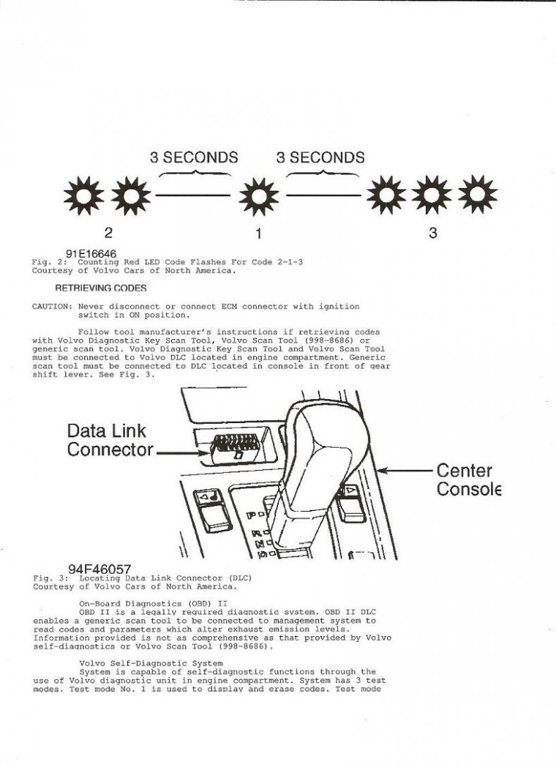

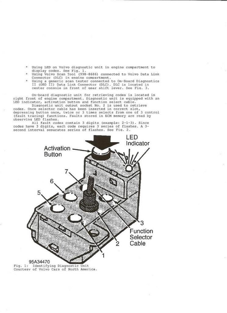

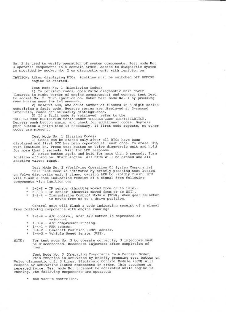

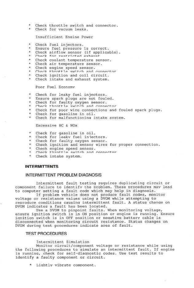

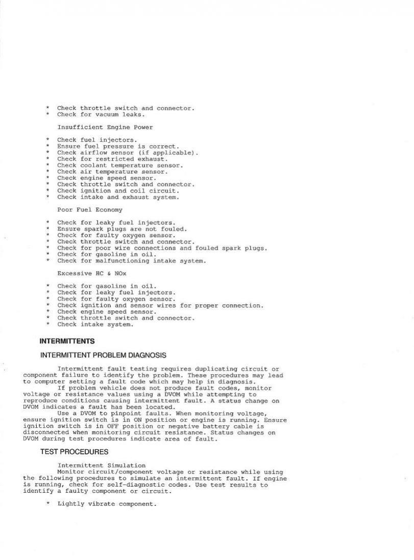

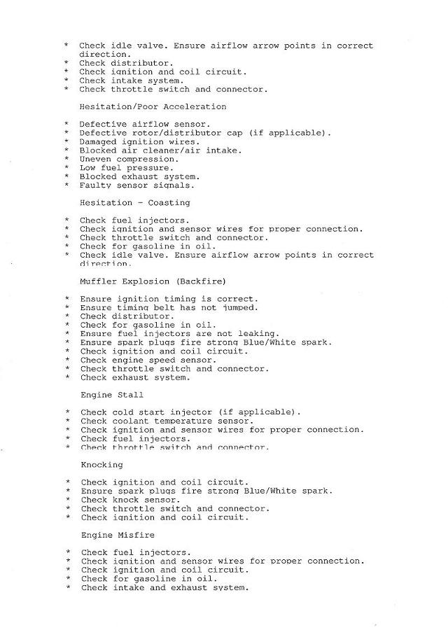

Aahh, have them all; see attached.
JPN
Attached Thumbnails 850 shut down-850-na-driveability-1-.jpg   850 shut down-850-na-driveability-2-.jpg   850 shut down-850-na-driveability-3-.jpg   850 shut down-850-na-driveability-4-.jpg   850 shut down-850-na-driveability-5-.jpg

2nd wave.
JPN
Attached Thumbnails 850 shut down-850-turbo-detailed-obd-i-1-.jpg   850 shut down-850-turbo-detailed-obd-i-2-.jpg   850 shut down-850-turbo-detailed-obd-i-3-.jpg   850 shut down-850-turbo-detailed-obd-i-4-.jpg   850 shut down-850-turbo-detailed-obd-i-5-.jpg

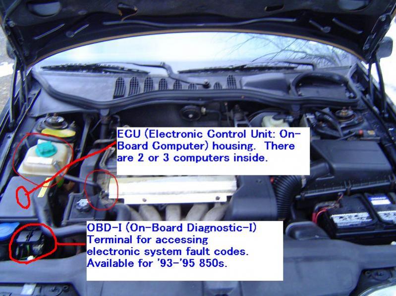

3rd wave.
Was your 850 turbocharged, BTW? Some codes may be different for turbo & NA.
JPN
Attached Thumbnails 850 shut down-850-turbo-detailed-obd-i-6-.jpg   850 shut down-850-turbo-detailed-obd-i-7-.jpg   850 shut down-850-eng-compt-ecu.jpg
