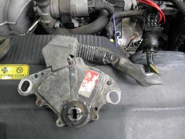

Volvo has a different way of checking the transmission fluid. This is their procedure. I would check the level of the fluid and if you're unsure what color or smell the fluid should have find a buddy you trust who knows cars and have him check it.
CHECKING FLUID LEVEL
1) Ensure vehicle is level. Apply parking brake and gear
selector lever to "P" position. Start and idle engine. Move gear
selector lever through all gears, while pausing 4-5 seconds for
engagement at each position.
2) Return gear selector lever to "P" position. Wait 2 minutes
and check fluid
The flashing light is not good but one of the causes that is simple is just rowing through the gears. Car on or off doesn't matter you just want to go all the way from one end of the shifters travel to the other a number of times. If the flashing is caused by dirty contacts in the PNP switch it might clear the problem up.
You need to read this:
https://volvoforums.com/forum/volvo-...s-s-v70s-9266/
Attached Thumbnails 850 transmission issue first car-transmission-dip-stick-location.jpg   850 transmission issue first car-trans-pnp-switch-out-car.jpg

i shifted it back and forth this relieves the problem for a while but im not 100% cause i took the battery off so it may have reset it it did it again after i started driving again ithink a new pnp switch would help the fluid is slightly to full when its hot
