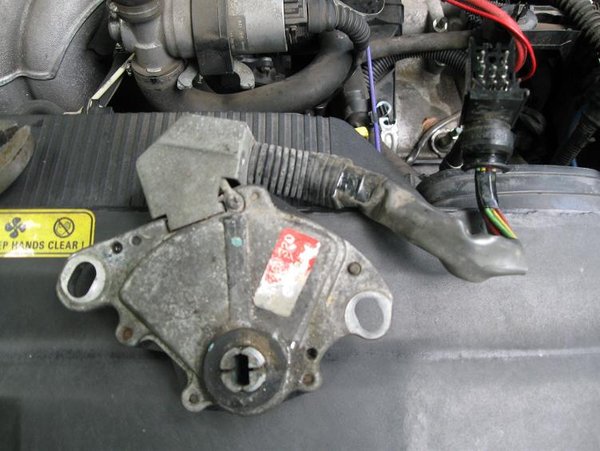

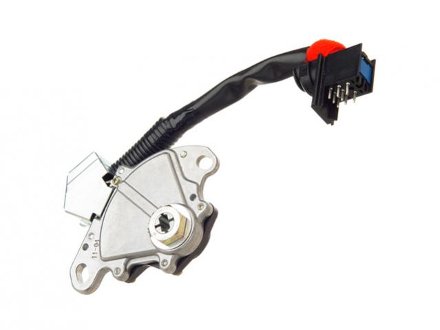

"Reverse light does come on when gear lever is in park"
If that is happening the PNP switch isn't adjusted correctly or it's broken internally. OR, something broke inside the transmission and the shaft that engauges the PNP switch is in the wrong position.
Attached Thumbnails 850 transmission woes-transmission-pnp-male-connector.jpg   850 transmission woes-trans-pnp-switch-out-car.jpg

reverse light does not come on while it is in park.
