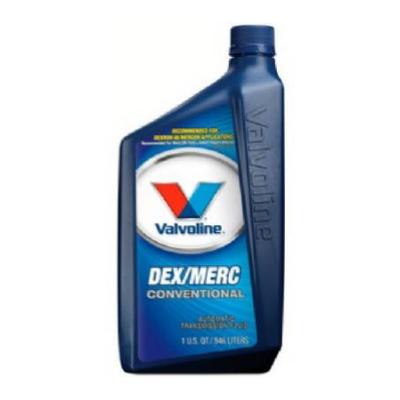

(Dexron III right?)
Dexron II or III is what it came with but neither Dexron II or III are available any longer. Dexron III replaced II and a while back III was replaced by Dex/Mec. It's a better grade of fluid and backwards compatible.
This is the clip you should check to see if it's missing, bent or in any way damaged.
Attached Thumbnails 850 Transmission Woes, help!-transmission-fluid-dex-mec-volvo.jpg

EDIT: Yea, had to go dig out my jug, which is full of old trans fluid I've forgotten to take somewhere, and Dex/Merc is what it was, (book said "Dex III" and the back of the jug said Dex III compatible, which is what I went by). Got Valvoline also in fact
