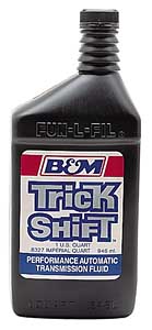

My 2 cents, it's just a better grade of lubricant and should work better (lower operating temp and better lubrication) since it's still made to a particular specification and again as long as it lists Mercon III or Dex/Mercon on the back it should be the same. I'm running Type F fluid as it's a trick we used to do to GM turbo hydro transmissions to get firmer shifts. Kind of like using B&M's "Trick Shift" but way less expensive.

Attached Thumbnails 850 Turbo Transmisson Noise-transmission-dexiii-mercon-bottle-1.jpg   850 Turbo Transmisson Noise-transmission-bnm-trick-shift.jpg   850 Turbo Transmisson Noise-transmission-lucas-conditioner.jpg
