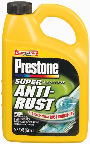

I'm a big believer in adding an anti rust additive to the system every couple years between flushes. It's cheap insurance and it replaces the additives that wear out in the coolant without having to pay 30+ bucks for new antifreeze as the antifreeze part doesn't wear out.
Attached Thumbnails 850r, random overheating-cooling-system-anti-rust-prestone.jpg
