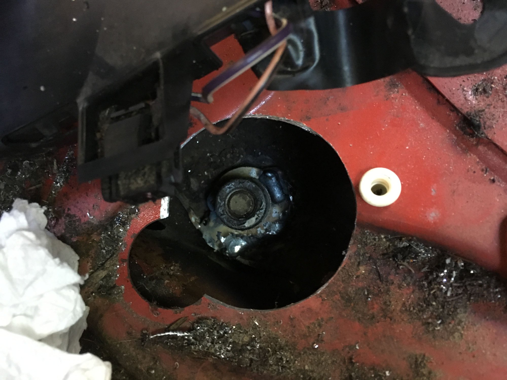

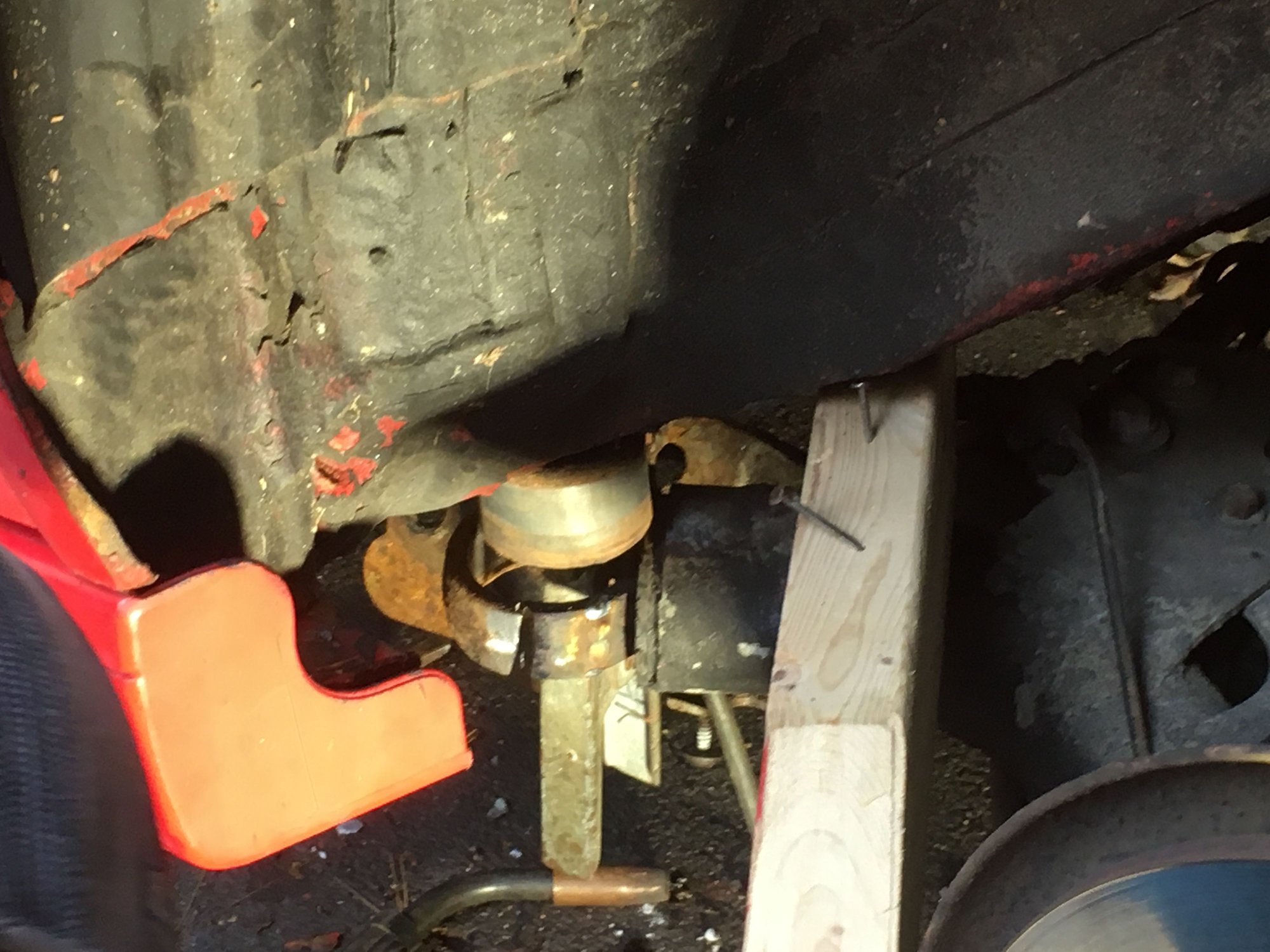

Cut bushing in half. Center was siezed on dowel. Cut the center piece out in about 30 pieces with the dowel spinning around.
Cut into subfloor under back seat and weld in top of dowel.

Old Oct 15, 2018 | 08:23 AM
860ARE's Avatar
Joined: Feb 2018
Posts: 176
Fluid film everything.. drive anothet 360,000 miles
