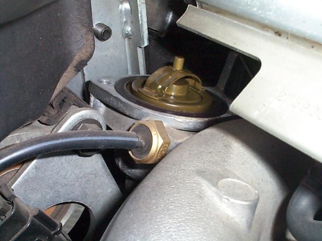

Check the coolant temp sensor to see if it's getting out of range. If it's going bad it will either feed too much or too little fuel to the engine.
