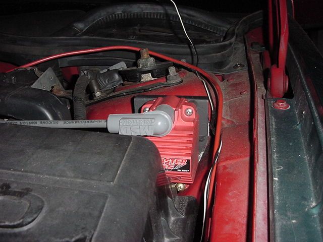

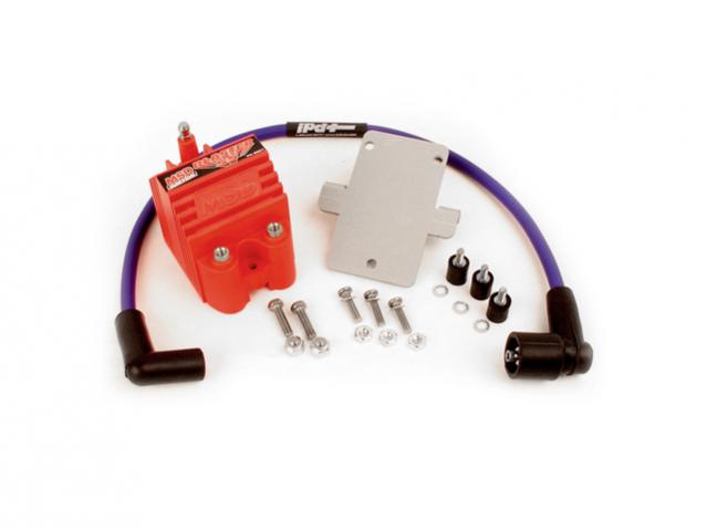

Old Nov 27, 2011 | 08:47 PM
And .... if you use the starting fluid (or drizzle in some gas) and it runs it's gas, if you still get a lot of cranking it could be ignition.
Good excuse to go with the MSD coil !!
The IPD kit or the DIY installation. Made my own mount, saved 65 bucks!
Attached Thumbnails 94 850 NA wont stay running-ignition-coil-ipd-kit.jpg   94 850 NA wont stay running-msd-installed-low.jpg
