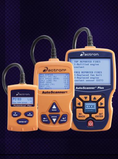

Check inside the vehicle just above the shifter on the drivers side. There should be a coil holder and it says something about OBDII connector.
If you have the connector you can read and erase codes with a OBDII code scanner.
Attached Thumbnails 95 850 Check engine light-diagnostic-port-obdii-console.jpg   95 850 Check engine light-obd-ii-code-readers-actron.jpg   95 850 Check engine light-obdii-code-connector-850-dash.jpg
