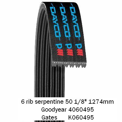

O.K. small update. The volvo's only in Arkansas didn't have a clue on the part and the dealer in Tulsa gave me the part # 9149644 for 95 volvos without a.c. not sure if it was on an 850. $44.00 special order + shipping and no returns. I'm not liking the risk factor so I'll do some more research.
Found a Duralast 495 K6 belt that I just barely squeezed on so all is good I hope. The 505 K6 was too long.
The K6 means for 6 groove pullleys and the 495 means 49.5 inches roughly. 50 seems to have been a better choice but I don't know if they make a 500 K6. I'll call and check. Back on the road and quiet again. Seems the old pulley on the compressor is busted. It turns but really full of wabble like it broke from the shaft of the compressor when the compressor froze. Hopefully this helps someone in the future.
