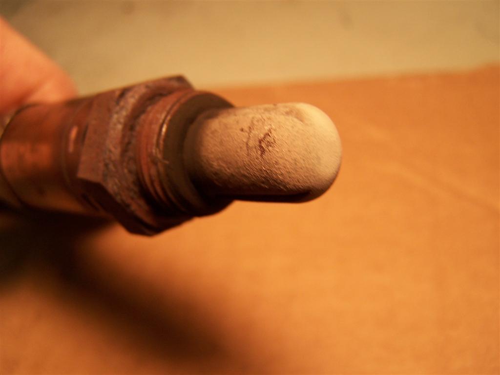

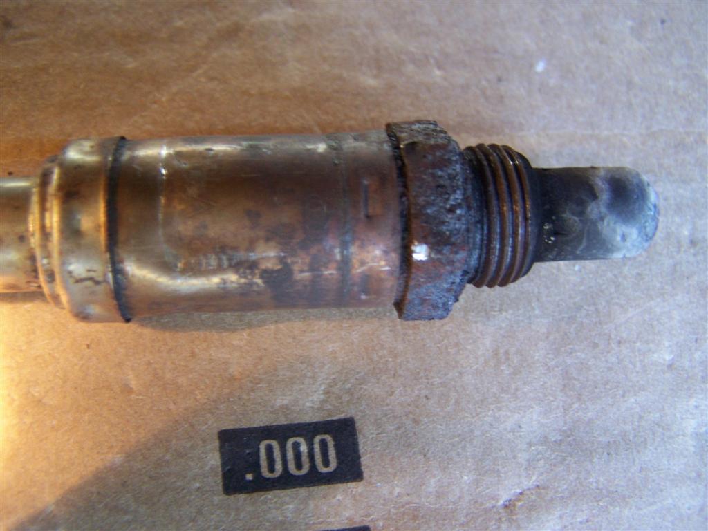

I am in New Jersey, cold this morning lower 40's, started and immediate CEL. Same code P0135, sensor1 heater. Warmed it up, stayed open at idle. Took it for a short ride until it went closed. Returned and let idle, went open after a few minutes. Then I held about 2k rpm and goes closed. Let idle = open. I was able to repeat, thinking the sensor heater is the issue. Hot exhaust = closed loop. So I pulled the sensors. Both are Bosch. Not sure if the correct ones but I was fooled by the clean look of the wires. Not so new, see attached pic's. Rear looks like they put it in with a vise grip on the body, slightly crushed. Anyway I ordered both and will try that. Would you guys have done the same?

The heater should just have key on power, I think, but I could be wrong. If the heater is getting power, the heater may have burned out. I have not seen that code ever, so at least it doesn't seem common.

update - after changing an axle boot, installed new sensors. Started up and w/in 2 minutes went closed loop. Took for a quick ride, stayed closed - all seems good with the ECU. (1) problem solved.
