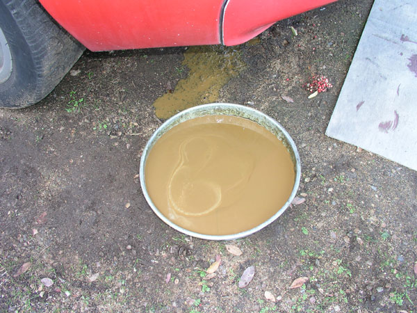

If you have a blueish hue to the smoke it's usually oil that's burning. If the smoke is white it's more likely you're burning coolant. That would be a head gasket that has failed.
Don't forget to check your oil to see if it looks like milk chocolate. If it's leaking into the oil you need to park it until you fix it. If it's burning coolant but the oil is still dark like oil should be that isn't good but at least you could drive it someplace to have diagnostics done.

The oil looks fine still and it's not leaking and it's not burning any coolant, so I don't think it's a gasket.
