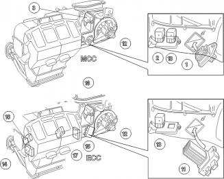

here's a diagram of both the ECC and MCC don't know which one you have.
if you have an ECC I'd look at the damper motors, MCC the damper cables or the ****.
if you have an ECC and you have codes the lights will flash when you start the car. This means there are codes stored and you can read them to help you track down the problem.

If you have ECC the module/controller might me bad. When I first got my Yellow one it did the same thing.

I'm guessing ECC means Electronic/Electric Climate Control and MCC means Mechanical Climate Control? So the only way to know which I have is to take it apart and look?
It is kind of hard to to describe exactly what is going on, but when I turn the know to change area of flow you can actually feel something in the know is turning properly. It is almost like there is resistance in some positions and none in others.
Old Sep 26, 2010 | 08:41 PM
tech's Avatar
Joined: Sep 2004
Posts: 36,349
Likes: 46
ECC= electronic climate control(Numbers for temps and AUT on the fan control and flow control ****.
MCC= manual climate control(Colors for temps)
