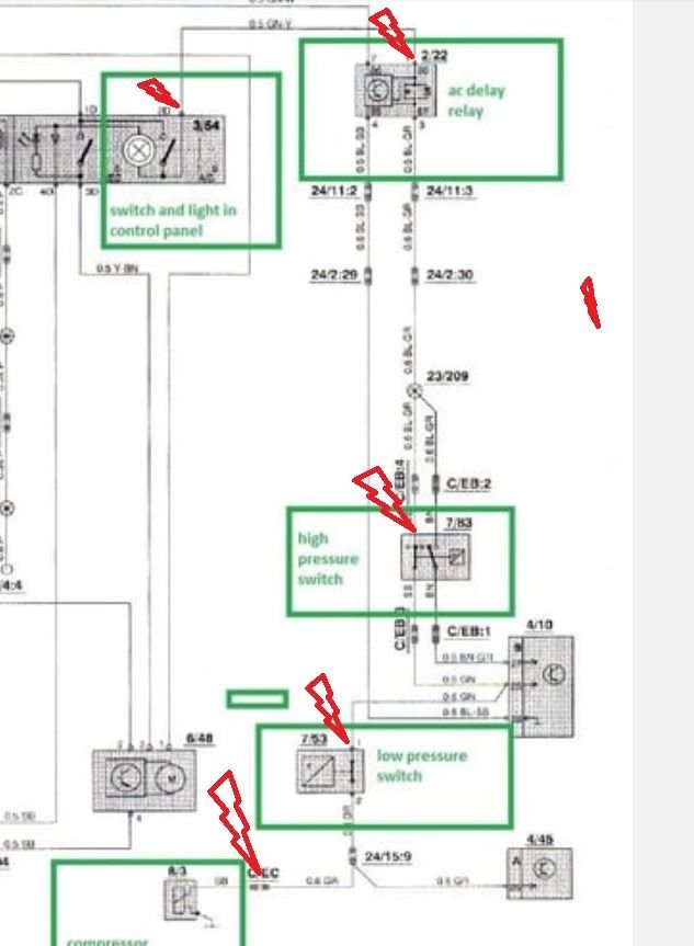

OK - you say "Power is going to the compressor." and it does not come on until you directly wire power to the compressor - it works then , you were able to charge the system and cold freon is created. Correct?

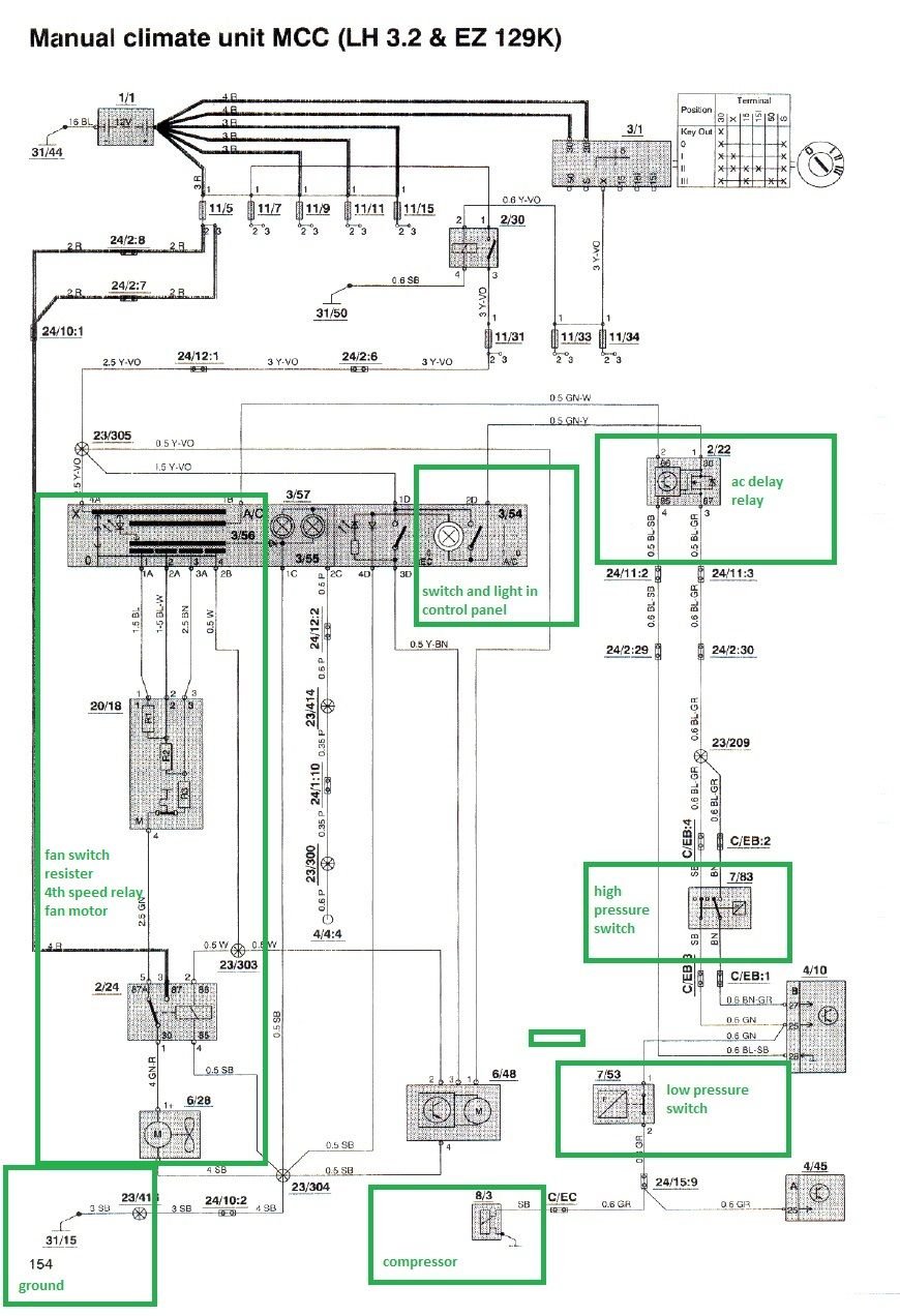

Power to the compressor goes from the switch on the panel, to the AC delay relay 2/22 (supplies power to the compressor a few seconds after the car is started, not immediately) then thru the high pressure switch (turns off power if too high) then the low pressure switch (obvious) then to the compressor. If it works directly wired I would suspect a bad connection in the delay relay - possibly a cracked solder joint that limits current flow. Your test light will light up - but the cracked connection won't send enough current to power the clutch.

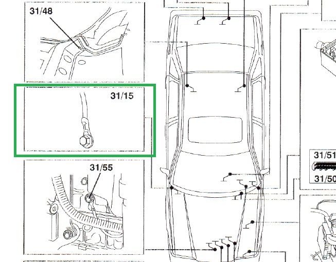

OR - "When fan is off, blue light for A/C is on at switch. However, when fan is turned on, a/c light goes out." This could mean there is a bad ground, causing the blue light to come on at the wrong time. (and grounding through the compressor circuit instead of 31/15.) The ground connection for the control unit and the fan is at 31/15. 31/15 is near the passengers right side panel. Check for a melted/poor connection at 31/15 next to the passengers right foot (behind the panel) But I would think if there were a bad ground the fan would not work properly also. That leaves a poor connection in the control unit. That's a pretty old car and I've worked on many for many years - but have not come across a bad control unit in a 850 with manual climate system. After this many years - anything is possible.

Correct. The one wire that leads to the compressor has 12v to it.
Bad ground is something I'm thinking, too. The relays are fine behind the dash. I have not checked the sensor grounds, yet. I also haven't taken the control unit out to test for ground. It is a 30-year-old car, and I did find one ground corroded off the block earlier this year and reconnected it.
Thanks for the wiring diagram. I'll go chasing some more gremlins tomorrow.

I looked at the relay housing and all the wiring looks fine. I can look deeper during daylight tomorrow. I think I’ll pull the control board anyway and double check all the connections.
I'm struggling to find the 31/15 ground. I pulled the carpeting back and found wiring but can’t see where there’s a ground stud.
Old Jul 29, 2024 | 12:25 PM
unamonkey's Avatar
Joined: Jul 2024
Posts: 6
Found the ground. No scorch marks. Looked at the wiring harness for the control board, no obvious signs there's anything amiss, either. I will mention if I try to jump the a/c relay from 30 to 87 (12v to 12v), it kicked on once, then wouldn't anymore after that. Is there a way to test the sensors to see if they are bad? Also, how much current is supposed to be coming out of the delay relay?

You can test low and high sensors with a test light, ohmmeter, jumper wire, paperclip. Jump past the low side sw with a paper clip, jump past the relay with a jumper wire.
The compressor, low side sw,high side sw, relay, are wired in series. Start at the control unit and follow power from one component to the next with a test light.
How much current? Compressor probably needs at least 6 amps - not sure if that's your question. ( sorry I don't imagine you having a way to measure that)
Are you sure the compressor comes on and stays on if you wire it directly to power at the compressor? (make sure the radiator fans are running - they might not if no power is going thru the high side switch, a signal goes to the ign and fuel system after that, probably to turn on the fan.)
