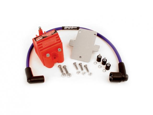

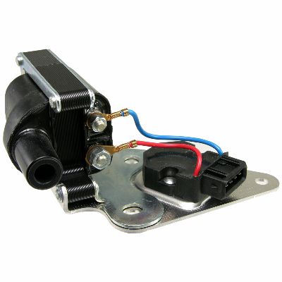

Was a new coil the cure ??
Attached Thumbnails another 850 no start issue-ignition-coil-stock-1.jpg   another 850 no start issue-ignition-coil-ipd-kit.jpg
