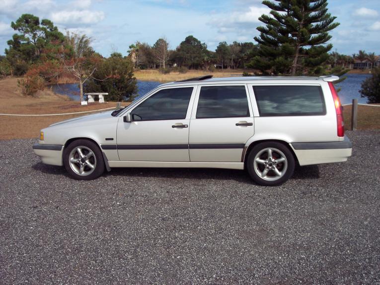

Thanks. Here's some pics
Sorry, only seem to be allowed to up load one.
Our driveway now really looks like a Volvo dealer.

Looks sweet! Just like mine but with a wing. If you don't want the wing, you can send it my way. heh .. How's the interior look?

I thought you might like the wing. I liked it too but I had to choke back the wing emotion and go for the bottom line.
Truth be told, It's a serious project car. 3 owner, 1st up to 2000(100K), second up to 08(has 128K on OD but not working, we all know what that's all about), third trashed it and had it repo'ed( door latch mechs are broken, linkages missing because of the repo man breaking in). wanted to post interior but couldn't upload( can't fault VF ...server space is expensive) your interior it way better. Mine is tan, the front seat skins need to be replaced but the foam is good and still very comfortable. So I'll buy the sewing machine I've always wanted (tools are theeeeee best investment man can ever make) , some leather and make new skins, for me and anyone else. Big time Vac leak, brakes don't even work until up to temp.

Man...I'm sure that picture does no justice, but that's a sweet looking Wagon
