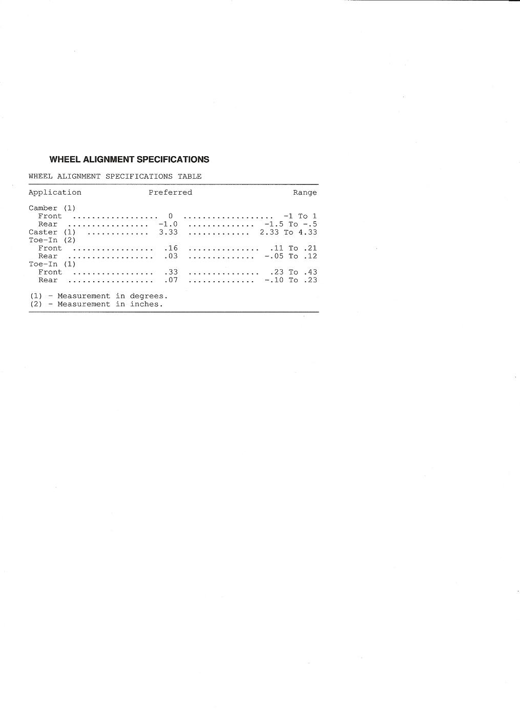

I was hoping that someone with alignment experience can help me out. I just replaced the inner and outer tie rods on my 95 850 turbo wagon and had new tires put on the front. It is pulling to the right now after the alignment. I went to Sears for the tires and the alignment. I went back today a week after the original alignment to have them redo it since it was pulling a bit and the the wheel (steering) isn't perfectly straight. So, they had it today, put it on the rack and gave me a print out. It appears that they didn't do anything since they didn't show any before numbers just actual numbers. Here are the numbers from the print out:
Front Left:
Camber -.2
Caster 2.6
Toe .18
SAI 9.7
Included Angle 9.5
Front Right:
Camber -.2
Caster 3.6
Toe .12
SAI 14.4
Included Angle 14.2
Front:
Cross Camber -.1
Cross Caster -1.0
Cross SAI -4.7
Total Toe .30
Rear Left
Camber -.7
toe .11
Rear Right
Camber -.8
Toe .08
Rear
Cross Camber .1
Total Toe .19
Thrust Angle .01
So, the only thing in red is the Cross Caster on the front end. The specified range is -1.0 to 1.0 and it is at the far end of the spectrum.
Thank you for any help. I would like Sears to make it right if it is something that they can make right. If I need to fix something else I will do so too.

Factory manual show the specs in the pic.
JPN
