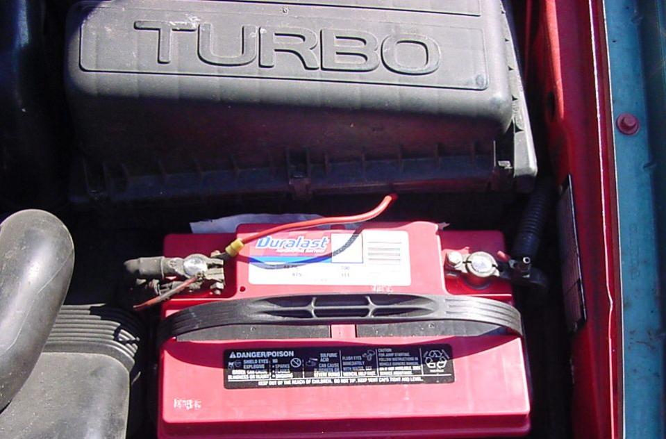

If you need a battery, one upgrade is to use a group 48. The stock battery is a group size 47 but the 48 is about an inch longer and has a higher CCA rating.
I have a 48 in mine and it fits nicely. The stock battery hold down fits as the width of the 47 & 48 are the same.
The battery washers look a little hooky but trust me they are worth the extra buck or two as they really do keep the corrosion on the terminals in check.
Attached Thumbnails Battery issue?-battery-replacement-48-47.jpg   Battery issue?-battery-retainer.jpg   Battery issue?-battery-washers.jpg
